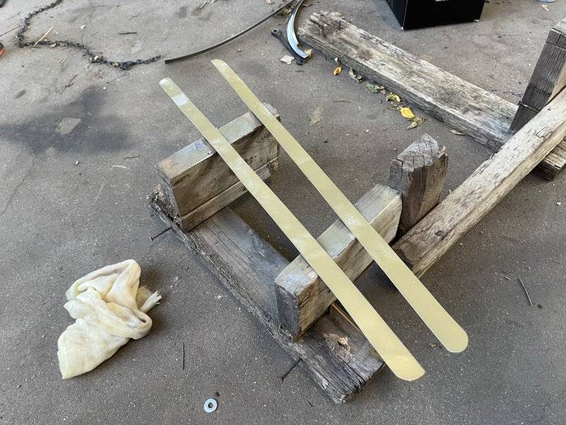

Looking great! Agree with Black Sheep, you can feather out the area under the chrome trim, mask that off and spray in some gold. Check your local automotive paint supplier, some dealers can custom mix factory colors including Spanish Gold into rattle can…enjoying watching your progress!

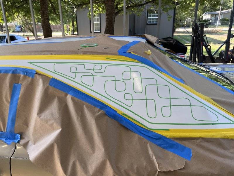

I ran out of big tape, but that’s the concept

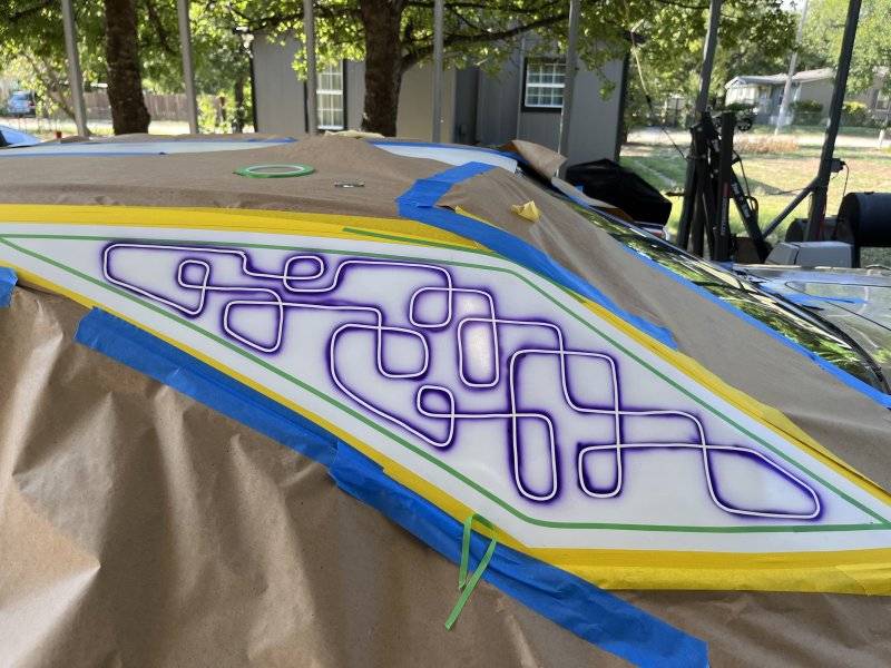

Anyway, back at it. Tape, spray, move, tape spray move. I like doing the fish scales better because I can get a little test shot off to the side, it’s not like the endless lines that’s kinda one and done

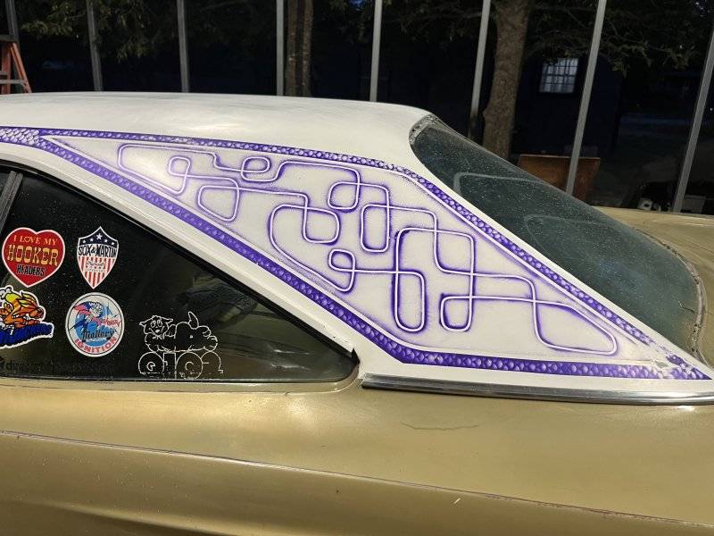

Well, this part is done, it turned out better then the other side and better then I could imagine. @Chongo 68 thanks for the inspiration!
Now I’ve got tape residue everywhere I got to take care of, and unfortunately I have to “weather” the roof a little bit. But I’m hot, tired, and a little hungry :lol:
Whooo, busy day. I wanted to get as much paint done today so I could get on with the next steps.
Roof paint and air brush done!

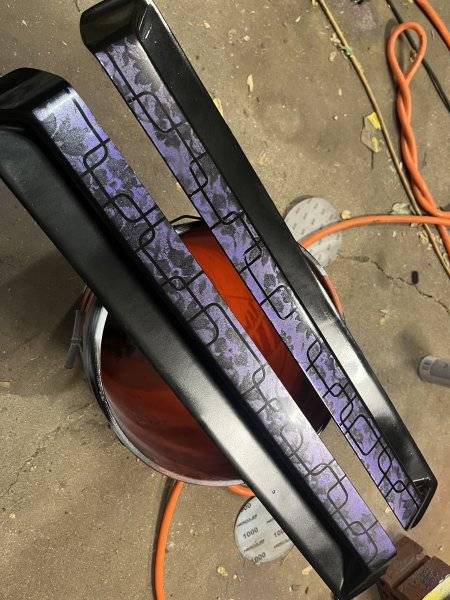

Hood scoops done!
Scoop insert done!
Bonus, front wheels repainted because it they were looking a little sad.
I know, high tech paint booth and parts holders just in case y’all thought I was joking about this being a backyard job :lol:
It’s absolutely nuts to take sand paper to paint, but that’s what I did. I had to hide a few mistakes, I kinda might have went a little far with the weathering. My fault for not knowing what I’m doing so I’ll have to accept. And I wet sanded all the over spray off. 800-1500, now I got to buff it.
