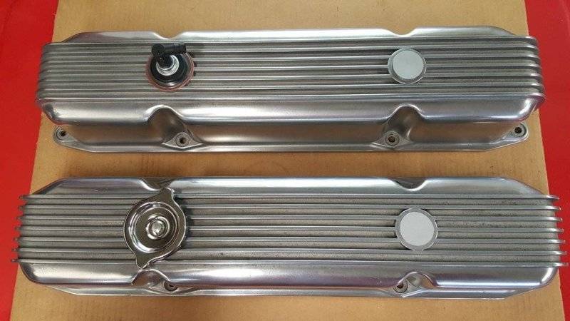

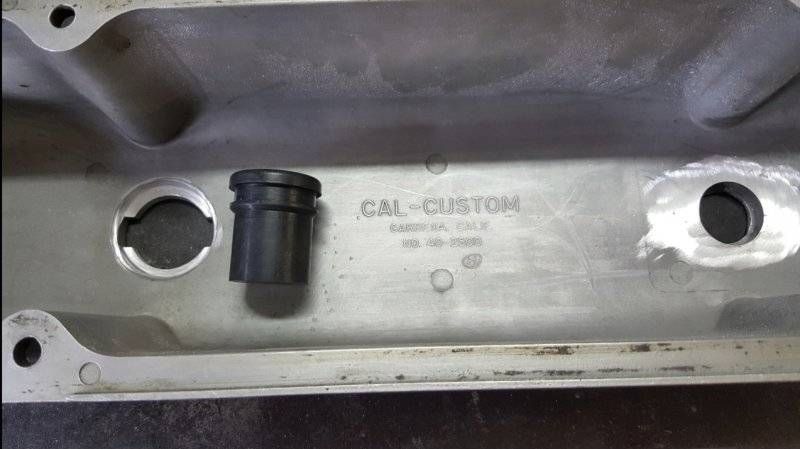

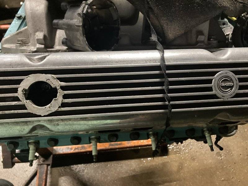

Alright, question time. I have these awesome call custom valve covers. The generic grommet I gave on my generic pvc sucks. It doesn’t seal great, it’s loose and sloppy. Is there better?

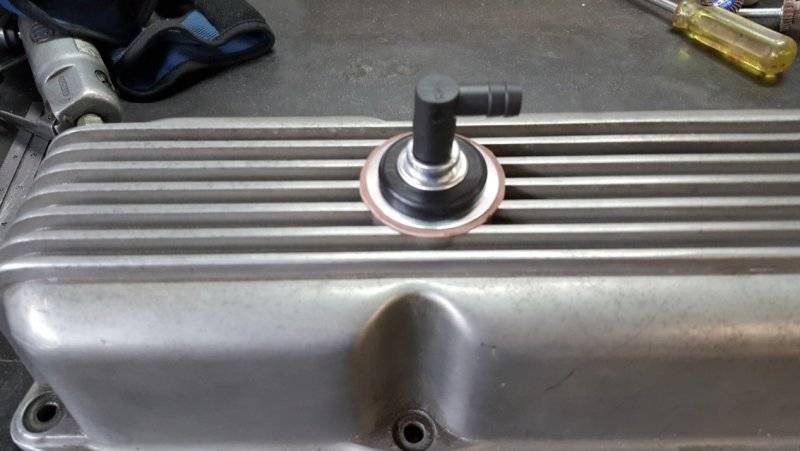

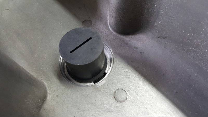

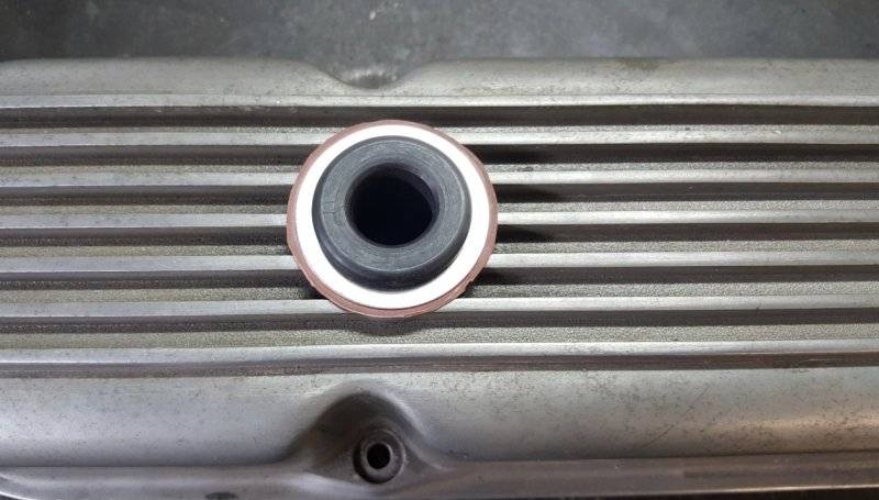

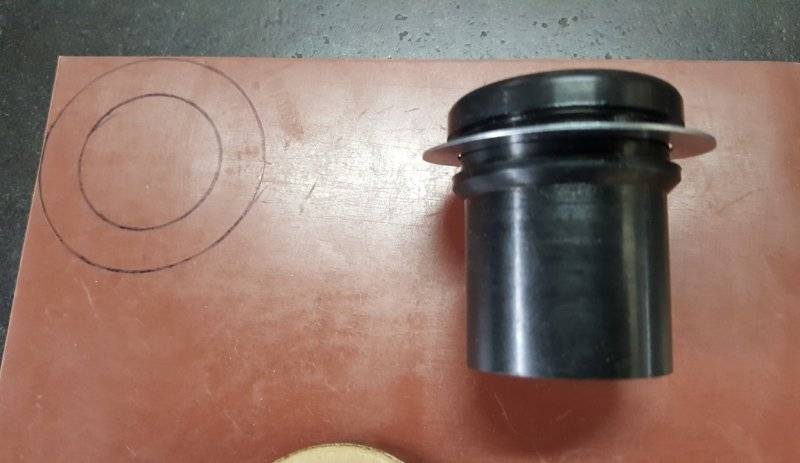

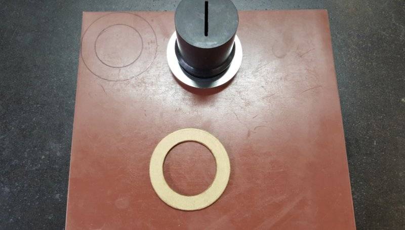

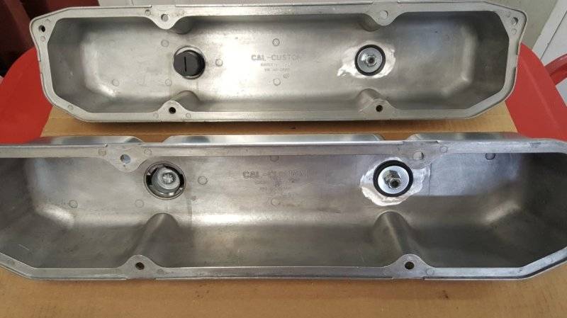

Here's what I did with mine...
There's a grommet for pcv if you don't have a baffle in the valve cover. Found them on Summit but you'll have to do your measurements.

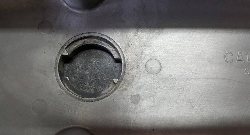

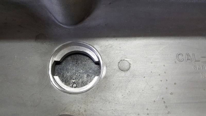

I ground off the locking nibs and might have even ground down to the thickness needed for the ring on the grommet.
Went to Lowe's and looked through their specialty hardware for washers, rubber washers, ect. Found some rubber gasket material.
My holes were already punched out when I bought these so I found a disk with a threaded stud at Lowes. Used rubber washers and nylon locking nuts to hold it all together.
Great info on the grommet issue. Nicer fix than what I had available years ago.

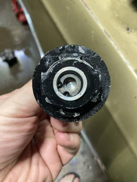

Since the k is out and clean now, have a look at the tubes for the lower control arms. Inspect for cracks, tears, wallowing out etc.
K frame is staying in, but I’m looking over everything. Even though I called this “heart surgery” and it’s primarily about getting the engine and transmission tidied up, I’ll also be fixing other things, and inspecting things. Kinda of a rerebuild
