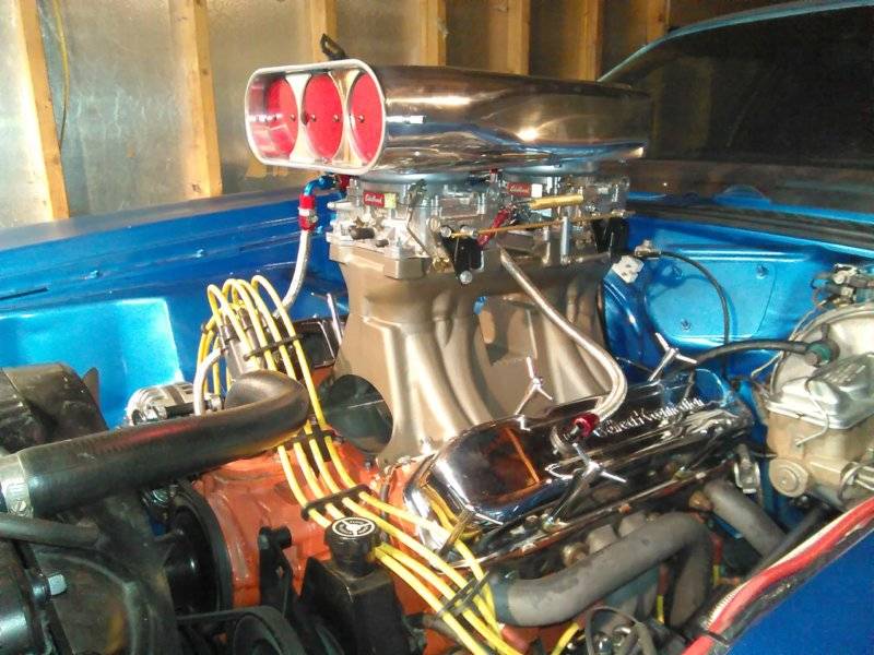

I have hedman headers on my 440 and the Accel precut wires with the 90* boots work great. it's all in how you keep them away from the headers. straight boot were a nightmare for me and I deemed them unusable for my application.
Thanks for the post! Would you happen to have a part # for those wires? If not, I'll just Google 440 MOPAR wires and if I only get one hit [at JEGS or Summit] then I should have the correct ones I guess. If precut wires will work that would be a time saver. I'll check it out!
I had to use the yellow wires with the orange boots, they are 8mm . I believe they have them in black. I got 25,% off by ordering them online through advance Auto , free shipping, the total was like 32.00. just punch in 440 plug wires, prefit
