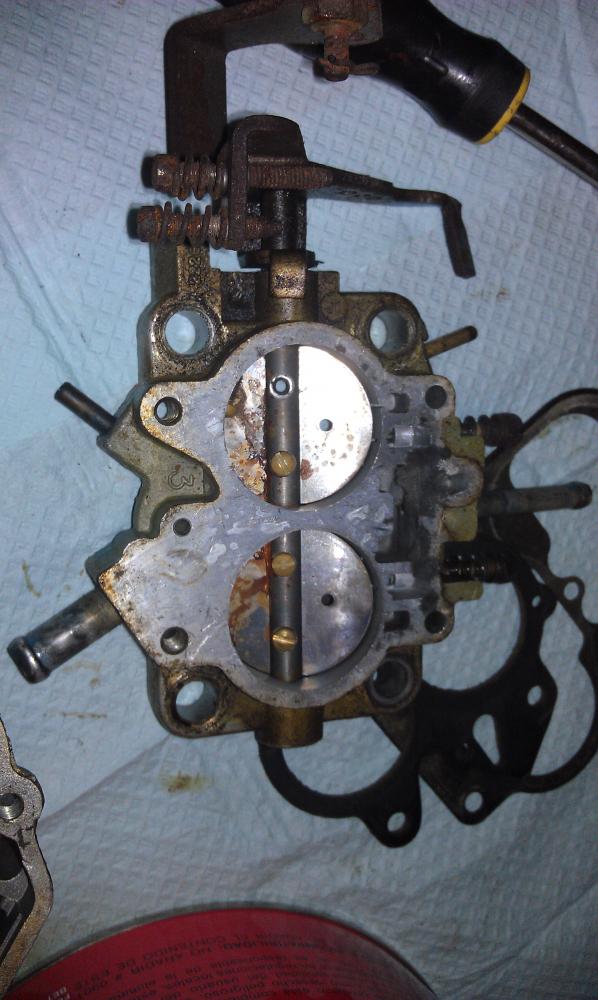

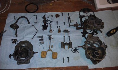

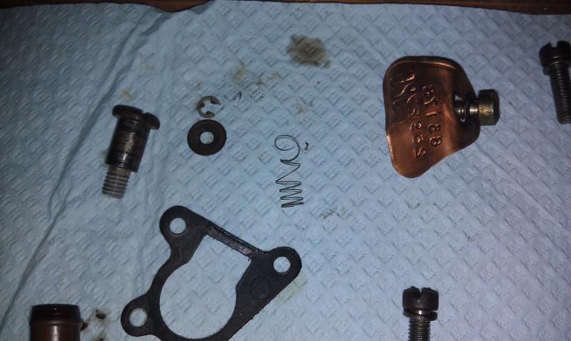

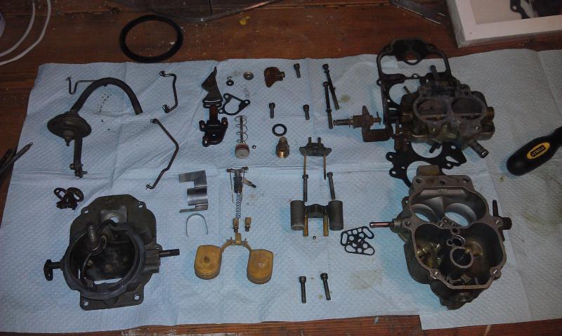

ok guys well I bought a carb kit and have it all torn down and soaking in the can of carb cleaner for the night. when I removed the carb the mounting bolts and nuts didn't seem very tight actually they seemed kinda loose also all the screws in the carb were also pretty loose feeling. The inside of the carb seemed pretty nasty also there was rust on the butterflies like water had sat in the carb at some point im guessing before I bought the car. I found that the small spring that sits on the top of the accelerator pump shaft was pretty mangled not sure how important it is and as it didnt come in the kit so I'm not really sure where to get another. I've attached some pics you can see how badly mangled that spring is if anyone knows where I can get a replacement that would be greatly appreciated. also the screw that is missing from butterflies was removed by me. IMAG0224.jpgIMAG0223.jpgIMAG0222.jpg
You are on the right track I think. The carb probably had significant vacuum leaks. The spring looks like it was pulled out with pliers t one time and caused the spring to stretch. You may be able to bend it back into shape carefully but a new one would be better. You should pull your plugs and replace them as well
I had the same problem with the carb on my Ford 351W. It would bog and/or stall when accelerating from a stop, or when going around a corner. I had to adjust the amount of fuel in the bowl as it was too low. It runs fine now.
Amazing how someone can mangle such a simple unit. No doubt it's gonna run a lot better when you're done.

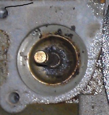

so I'm trying to figure out what this little spring even does I can't seem to find it in the exploded views of this carb. It sits on the top part of the accelerator pump between a little brass bown that ive posted a picture of here and the plastic cover for the whole thing. Its very strange as it has nothing to do with the pump itself as it had its own spring which alot larger. the only thing i can imagine it would be for would be to keep the little brass bowl in place. the only reason I ask is because I am wondering if it being a little bent up would even cause a problem. IMAG0215.jpg
Make sure timing light is hooked to # one,also look down the throat of the carb while it's running to be certain no raw fuel is dripping while idleing.
What carb is it?????
Good point and also make sure it doesn't continue dripping out of the booster once you shut the engine off. A dirty air bleed causes that most of the time. Pull the oil dipstick and see if it wreaks of fuel. Oops didn't read the complete thread. The spring returns the pump to a static position for the next shot of fuel.
I believe the large spring that sits on the shaft does that but the tiny spring is just way to small for that purpose.
