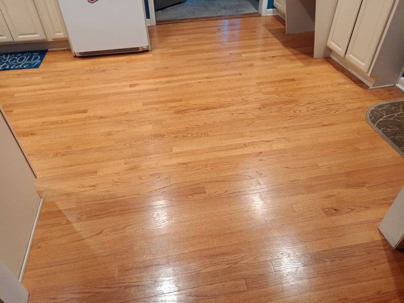

I have hardwood in my whole house including kitchen. House is 65 years old. Floors still look geat. I’ve done hardwood in other houses too. 3/4 oak pre-finished is my preference. Bella is my choice.
