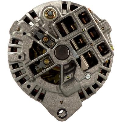

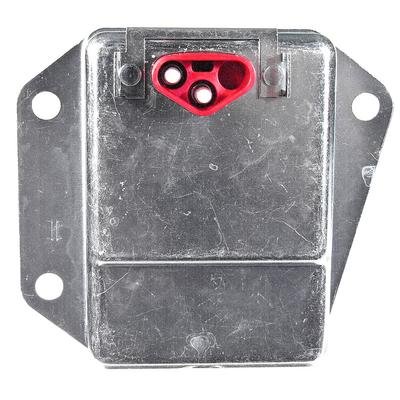

here's how it's wired, a latter 4 pin ballast & electronic regulator with dual field alternator...
