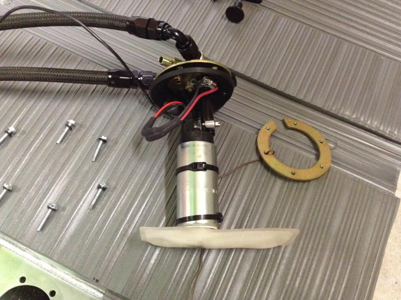

So to make a LONG story short, I finally solved my fuel pressure issue. It turns out it was a loose cable tie on the upper fuel pump hose IN the tank. Essentially, once pressure built up above 28 or 29 PSI, fuel started bleeding past the clamp and back into the tank. Of course, there was no way to see this since it was in the tank. Also, when I replaced the fuel pump I didn't look at the upper clamp. It never dawned on me that it might bleed fuel this way. Of course, it does seem retarded. Why have everything use AN type fittings and then have a crappy hose clamp holding the in tank pressured fuel line???
Here is a picture of the fuel pump assembly. You can see the small band clamps (which have now been replaced). By the way, mounting one of these guys back into the tank takes some finesse. The metal ring on the right hand side sits inside the tank and the screws thread through that. I used two long 14 gauge copper wires to pull it up tight through the fuel pump mounting holes so I could start the other four screws, then I pulled the wires out.
I usually like to consider my troubleshooting skills to be pretty decent, but I have to give myself a "D" or worse on this one. It just never dawned on me that a leak like this could be an issue, but a lot of things didn't add up, although I kept trying different things.

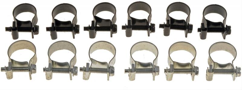

You need to use these clamps.
The old school clamps don't clamp good enough for the higher pressure.
