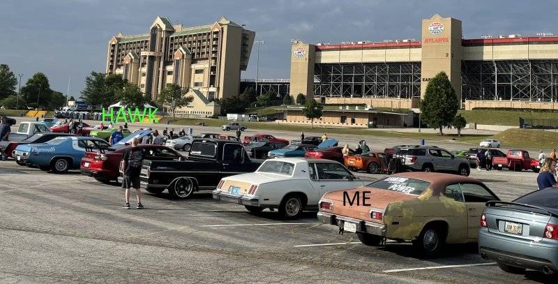

Good to see you on Day one. The 73 Duster overheated badly near Augusta and the water pump seized on me, so I called in my rescue ride. Had a great time through the first couple days, but the 6 hour parade out of Atlanta was rough on the old Slant 6. Definitely doing next year. Here is my ride....

Sorry to hear about your water pump. Yes, the stop and go driving, especially in the heat, was hard on these old cars. Unfortunately, there were a number of casualties; sorry yours was one of them.
By the way, the picture of your car really doesn't do it justice - there is no significant rust on your car - pretty amazing for an old car!

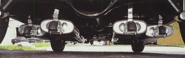

Hawk, I watched an episode of Roadkill Garage last night where they were trying to make the Crop Duster more street friendly, with a goal of still running 11.50's so that they did not need to install a roll bar. The engine was a 383 based stroker putting out 548 flywheel horsepower. They changed out the 4.10 gears for 3.23's, replaced the 850 race carb with a 750 DP, and added a full 3 inch exhaust system. The car ended up running mid 11's at 119 mph. It was interesting to me because that's just about exactly what my car ran with 3.55 gears, a 750 DP and a full 2 1/2 inch exhaust. Likewise I did not want to go faster because of the roll bar requirement. Both cars used drag radials. I figure the Duster was a few hundred pounds lighter than the fastback Cuda, so that accounts for the extra horsepower.
Interesting. Obviously, my 70 Road Runner is heavier than your Cuda, but otherwise I have a very similar drivetrain. I have a 3.55 rear and a 2 1/2" exhaust. I have to go back and see what the CFM rating is of my F.A.S.T. throttle body, but I'm pretty sure it is north of 800 CFM.

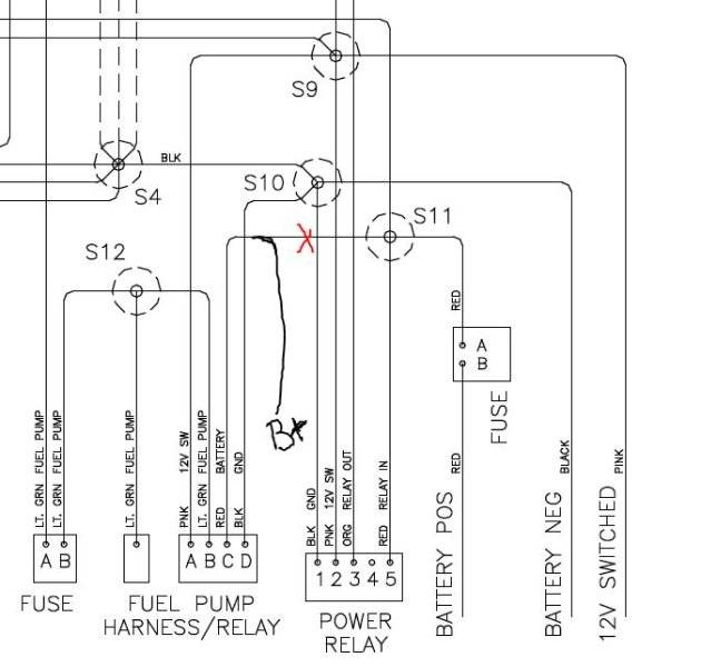

I'd be interested to see your results. I FINALLY got my GTX possibly sorted out from a WOT/fuel pressure issue where I ran a separate B+ from the battery to the fuel pump relay becasue the FAST factory wiring wasn't up to the task of running everything off the single B+ in.
Thanks for the note. What you mentioned is an interesting possibility and one that I definitely think could be possible culprit. I haven't yet had a chance to work through this on my car (after all, it drives awesome and I have had other priorities). Having said that, I'm hoping I can make the trek to see @Nxcoupe some time late in the year or early next year and see if I can buy some dyno time so he can help me sort out what is going on.
