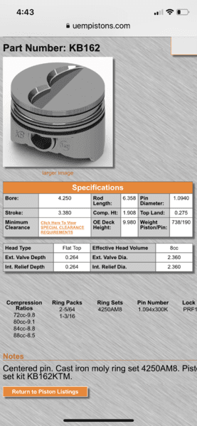

My mistake, with valve reliefs 8.9 -9.0. An 8 CC relief seems pretty big for a stock type piston.
I’m pretty sure this is what he has. Some web sites advertise 5cc others advertise 8cc
That pic shows a very large valve relief. It should handle a big cam. Looks like it could be 8 CC.
