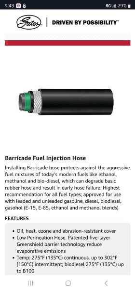

Recommend changing all standard rubber fuel lines with hose rated for fuel injection.
Yep, I bought fuel injection hose for all of the rubber connections for the Charger...cheap insurance
