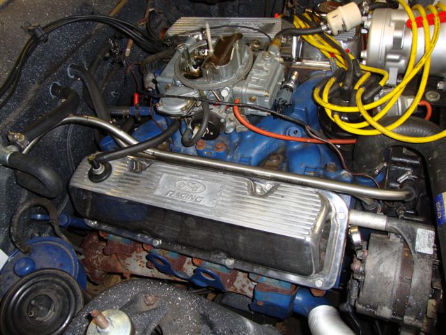

I did that on my 71 Ranchero. Came out OK and really cleaned it up. I won't take credit on the rest of the engine compartment detailing (was like that when I got it) but had I kept the car that would have been fixed as well.
