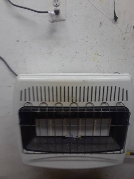

I was going to put in floor heat in my barn back in 2003, couldn't afford it so I evenutally bought insulated doors got the floor poured, used 1" ridged foam on outside walls inbetween poles caulked inbetween seams to stop air flow put purlons on the inside to flush out with 2x 12 above sheeted walls with osb and drywall sealed those, creating a dead air space in the walls which is free insulation. my barn never gets below 42 degrees no matter how cold it is outside without any heat. why? ground heat from the earth that's why you bury water line min. 42" below here. I bought a propane wall heater for $260.00 I leave in on 1 and it rarely turns on and keeps it around 50. I can turn it on 3 and its 70 in a half hour. then in summer time when its 90 out its 70 in my barn. I rarely lay on my floor, when I do its on a creeper or something forgiving on my back. Insulation is the key and utilizing free geo thermal is the key to cheap in my opinion. if I ever move and build a new barn no in floor heat for me.
that is why old structures had thick walls of stone for thermal mass warm in winter and cool in summer

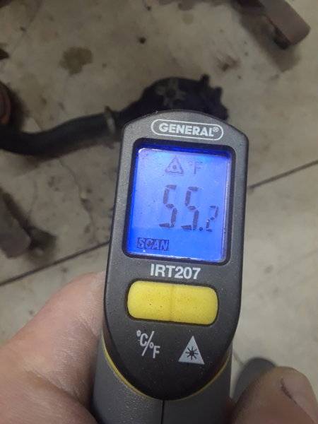

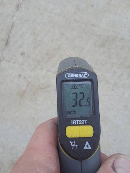

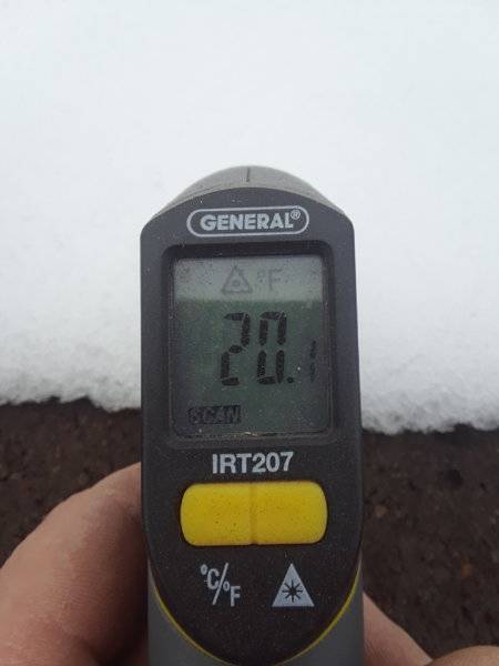

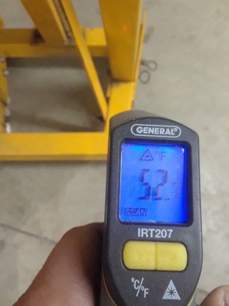

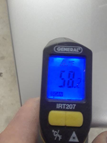

my only heater
set on #2 (1-5 settings) for approx 3 hrs. while I was working out there. stays off most the time after initial heat up from 55 degrees when I went in there earlier. on setting 1
68 degrees

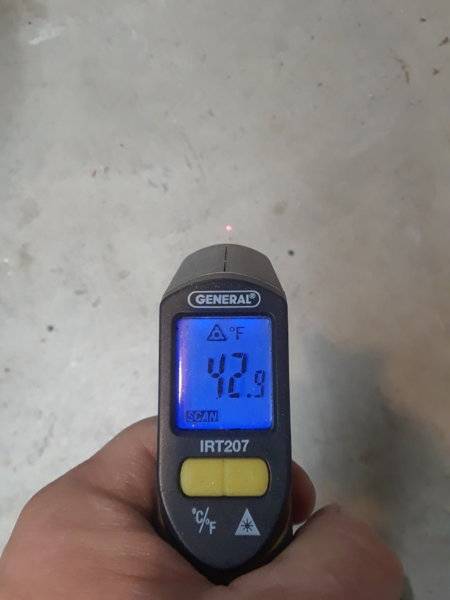

outside temperature
outside concrete temperature
concrete temperature in unheated insulated fab and metal working area.
heated concrete area 15 ft. from heater

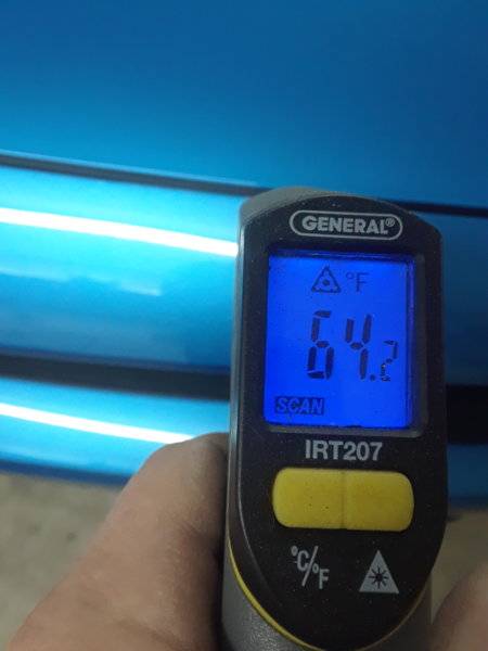

cherry picker, metal must retain cold better
hellcat 20 ft. away
old water pump housing laying on floor 25 ft. away from heater.
under 350 yr. for propane when it had its own tank. using for 5 months year approx. now its tied to my main supply for my house. been heating for about ten years. cost of heater and gas line around 500.00 3500.00 total energy cost of propane. 4000.00 for ten years of heat no maintenance , no up keep. not 100% sealed some gaps around entry door, exhaust fans, and attic access. can work all day no co2 dizziness or headaches.
