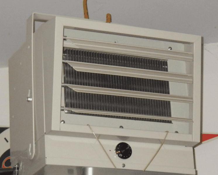

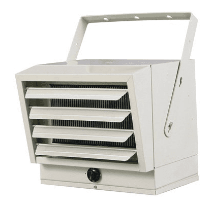

My garage is a whole 2 car with insulated door and ceiling. I went with a Farenheat 7500 watt max (overkill) electric and very happy with it. No glowing coils, no flames, no fumes, and it's made the states.
Northern sells the 5000 watt.
https://www.northerntool.com/shop/tools/product_595_595?cm_mmc=Bing-pla&utm_source=Bing_PLA&utm_medium=Heaters, Stoves + Fireplaces > Electric Heaters > Electric Garage + Industrial Heaters&utm_campaign=Fahrenheat&utm_content=17303&msclkid=c10ff0af369d1a7861d8ab77c33d4708

67coronet440 what brand is that heater you are showing?
Daves69 what brand is your heater?
I went with the Fahrenheat 7500 watt max. I wanted "more" than enough, without open flame or glowing coils. Bought mine at Farm and Fleet. Posted a link to Northern Tool on page 1.
