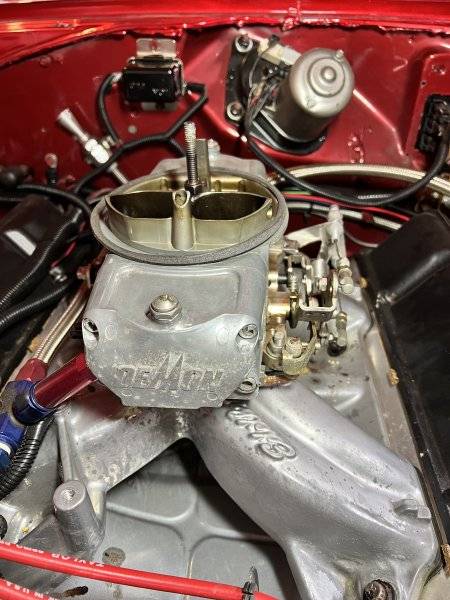

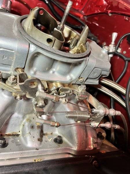

Hi Everyone,
Like the title says, need some help with removing my carb for cleaning. I am a complete newbie with it, but have a 750 Demon, need some guidance on taking it off to get it cleaned up and try to clean out some of the gunk in there. Before getting the car from my dad, it sat unstated for a bit. Attached some pictures to help, thanks!

Welcome. We're all glad to be of help. If you're not sure of remove/reinstall carb procedures, not sure if you'd be up to do a rebuild. But, first things first. Do you have FRESH fuel in the system ( tank to carb ) ?

I was going to hold off on rebuild, but take it off, get some carb cleaner in the main section and remount to see if that helps.
Does that carb have a power valve like a Holley? Usually, one good backfire, and the power valve was done.
I think those Demon's have power valve blow out protection but that is not 100% effective.
Also they can dry out from sitting around and rupture.
Good point posted - replace the power valve.

For power valve replacement, looks like taking off front section and comes out there?

A Demon is very similar to a Holley and gaskets/parts are interchangeable. It is kind of a copy just so you know.
Holley also post tech tips on You Tube.

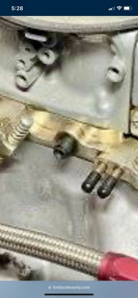

Curious, is this an open port or a mounting point for the electric choke?
