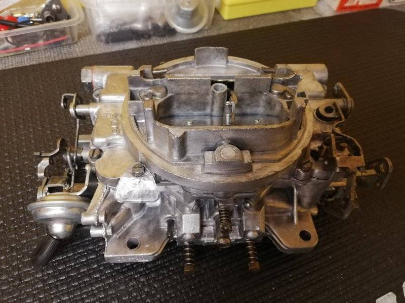

Jonas, I believe you did not test one of the best squarebore carburetors.
The Carter AVS
Ah, yes! I played around a little with my 440 one.
That extra air mix screw and three step rods are cool.
Didnt test it much sadly as the secondary throttle shaft was cracked.
I hope to find a donor shaft someday so that mine can be in top shape. :thumbsup:
