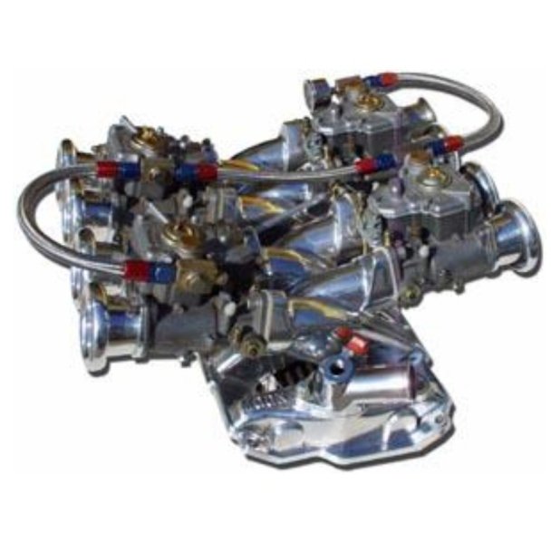

I think a weber can vary depending on how it's choke is set up. We had a 327 in a road race car with 4 webers. I think ours were 300 cfm per barrel. It had 4 carbs 8 barrels for a 2400 cfm total. I think most weber 48s are larger even then 380 cfm! I do not see it helping the case of small is better? The webers x4 intake was Kool but impractical. Certainly not a weber expert. I never got to play with it. The weber set up was sold, looked identical to this one below. It was on a car like this....sitting in our trailer.

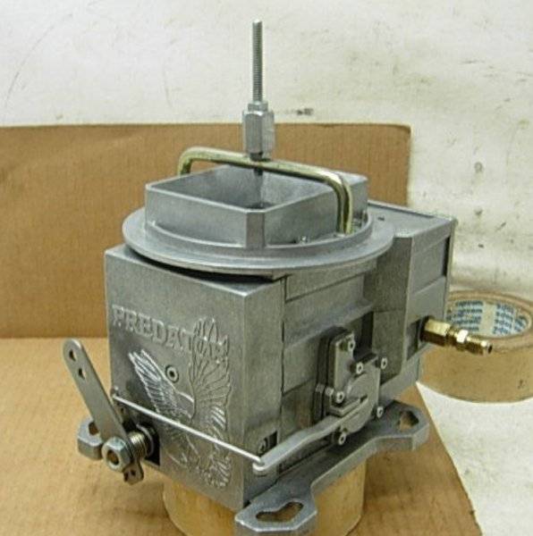

Variable venturi carb...incredibly responsive with 1000cfm you could run it on about anything. On a mild 440 we switched out a Avs on a 70 challenger..went from a 14.1 to a 13.7! Later we tried it on our 510 w slicks and it cleaned out the 8 3/4. Predators were great and terrible ALL at the same time! Last time we ran one it filled the engine w gas and it bent a rod.Lol
...not recommending it.Lol

I remember them.....and didn't it get nick named 'the toilet' ?

Post #84. Nope, the 48 IDA flows 296 cfm [ per barrel, with 38mm chokes. ] The four Webers were an IR system [ independent runner ]. Each cyl sees ONE carb barrel, in this case 290 cfm.

On a 8 barrel weber each barrel has to feed the demand of one cylinder. Each cylinder and carb is independent of each other. So 296 cfm is all one cylinder has available, it only draws from the carb every other revolution on a 4 stroke.
A open plenum 4 barrel all 8 cylinders draw from the whole carb. The weber only see's vacuum when one cylinder is sucking on intake stroke. A 4 barrel is feeding the demand of all 8 and sharing it(in a sense).
Feeding cylinders individually has its advantages... but feeding 8 cylinders at one time also has its advantages. Simplicity for one.

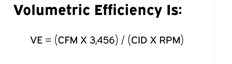

To get a cfm more info is needed. Need v.e. and rpm. Probably another equation out there but this comes to mind:
