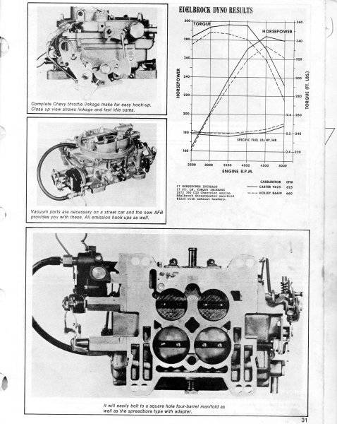

Ah, yes the Holley vac carb. Didn't do to well against a 625 AFB [ see below ]. Made less tq, less hp & used more fuel....
Over on FABO, you will see a thread where a Poly Stroker engine had a 600 vac sec Holley removed & replaced with a Edel AVS2. When the owner went for a test drive with the AVS & went to WOT, he thought the trans had kicked down to 2nd such was the acceleration improvement. But no, still in high gear....The smelly was also gone....

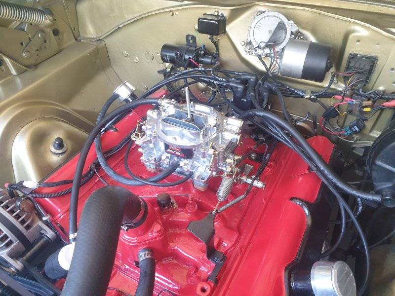

I've had a Holley 1850, 600 vac sec on the car for 4 years. The cheapest most basic 600 Holley. Performs faultlessly. I've also got an old Holley 700 D/P that was was on the car when I bought it. The car is a bit faster with this bigger carb and I swap them around for fun.
I wanted to try something else and after A LOT of research and debate I bought a Edelbrock AVS2 650.
It's been on the car for a week and I have mixed feelings about it.
It's true that the wide open throttle acceleration felt stronger than the 600 Holley (and similar to the 700 D/P).
It's true that I used to get an "engine smell" after full throttle with both Holleys that is absent with the AVS2.
However...the low speed throttle response of the AVS2 is weaker than both Holleys, which I was not expecting. I'm assuming it's a tuning issue.
There's a big full throttle bog as well that I'm trying to tune out, which is a fairly common issue.
I also think the Holleys are built better. The linkages on the Edelbrock all have lots of play in them, held together by tiny clips. It feels a bit cheap. The Holley linkages feel more solid, better quality.
So, the jury is still out. I've got to tune this carb properly before I can give a verdict.

First impressions: smaller and lighter than the Holley 1850 600, and way lighter than the 700 double pumper.
Seems a quality piece, MADE IN THE USA is reassuring, looking forward to getting it installed. I'll take the top off on the weekend and
have a look inside.
Later...
So I set the floats and locked off the choke by putting a thick washer onto the shaft where it pivots and tightening it down.
The floats were way off from what the manual specs are. There are 2 settings. First you have to set them with the top of the carb upside
down. I set them at 7/16". Then you turn it over and set the hang. I set them at 1".
It's all a bit imprecise for my liking, bending arms and tabs. I'd prefer a solid arm and a screw adjustment
but I suppose they are all like this, it's the first time I've done this. I just think bending metal leads to fatigue and possible changes over time.
Later...
Well I've been driving for 2 days now with the new carb and I'm happy with it but surprised as well.
I was expecting great low speed,
part throttle response with the smaller primaries, but it's no different to the Holley. However, give it the full beans and it's definitely got more torque. On the first run yesterday I punched it on the highway in D at about 60mph and after a momentary bog it took it off so fast I thought it had kickdowned into 2nd.
Later...
Today I did a few short runs of about 10 miles after fiddling with the accelerator pump arm (putting it back to the center hole from the leanest setting I did have). Not much difference, so I put it back to the leanest hole again when I got home and tightened the secondary flap screw slightly. Haven't tested this change yet.
This is basically "out of the box" with only my rudimentary adjustments during some very hot (95-100° weather), so it's clearly got more to give.
One big plus - on both my Holleys if I got on the throttle heavy I would always smell the engine in the cabin.
With this Edelbrock, I can go full throttle and no smell at all.
Later...
I checked the accelerator pump and it works, even squirt both sides.
Haven't done the other test yet, will report back when I get there.
More street driving impressions, car feels slightly stronger in full throttle applications but weaker than the Holley in general loafing around. Not what I was expecting at all, must be a tuning issue.
