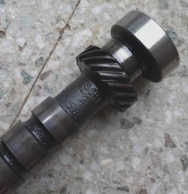

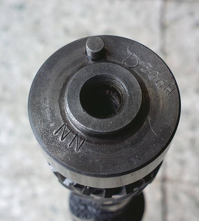

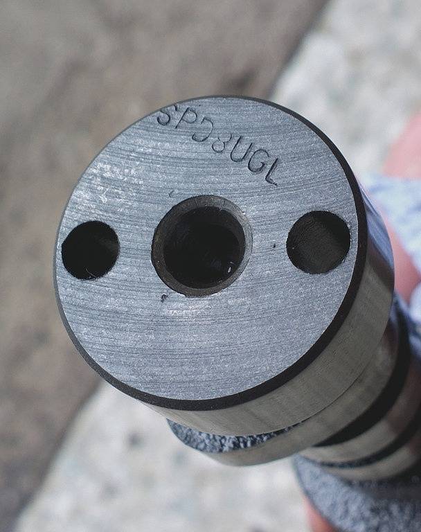

Hello everyone. Maybe somebody knows how identificate camshaft by stamped numbers. Car is 72RR, engine from 69 HP 440 SixPack. Compression 12:1, very rogh idle.

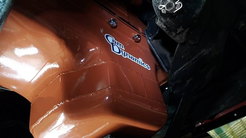

On oil pan i find old Cam Dunamics sticker what was restored by me. So i think its CD camshaft.
Would that 306 be a duration?I add some pictures(sry my bad english)
That's probaly the grind number? Just a guess but 306H first thing comes to mind is 306 hydraulic... didn't crane came own cam dynamics? Give crane a call they maybe able to help.

Haven`t heard that name in a while ! no help here ! We used to run a cam dynamics 785 lift roller in one of my hemi`s tho.
I have an old mechanical Cam Dynamics cam in my old Vette - pretty wild cam - I call it my old school cam. I believe Crane did buy out or somehow acquire Cam Dynamics. I glanced at Crane's website and didn't see a 306H hydraulic cam - I think a 302 was the biggest one. It could be they have phased out some of the bigger hydraulic flat lifter cams with roller hydraulic cams. If you keep doing some Google searches you might come up with something.
