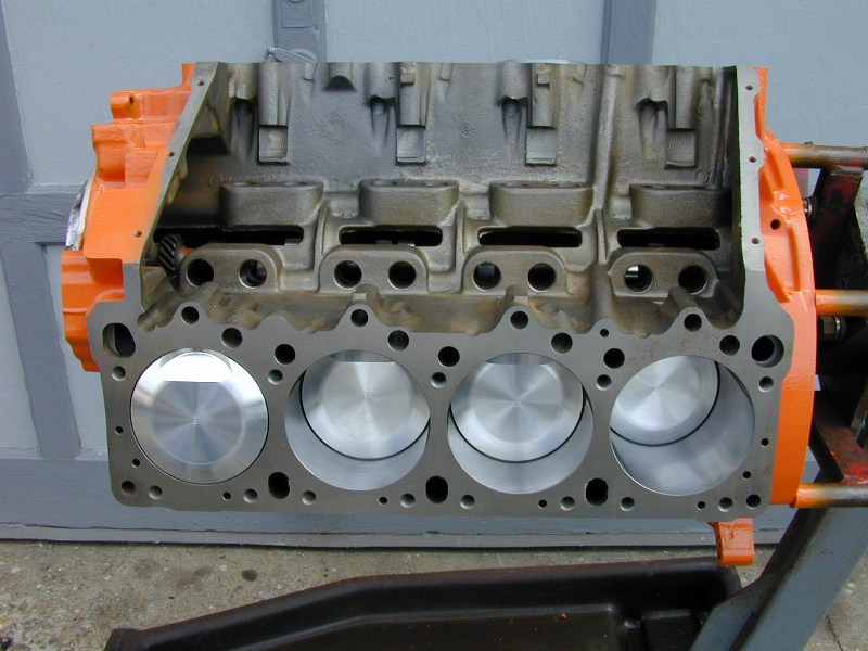

Be that as it may,a small hit shouldn't hurt. I am no expert by any means,I'm just another addicted MOPAR junky that just goes faster and faster. I use a siamesed bore mega block that I bought over 10 years ago.
