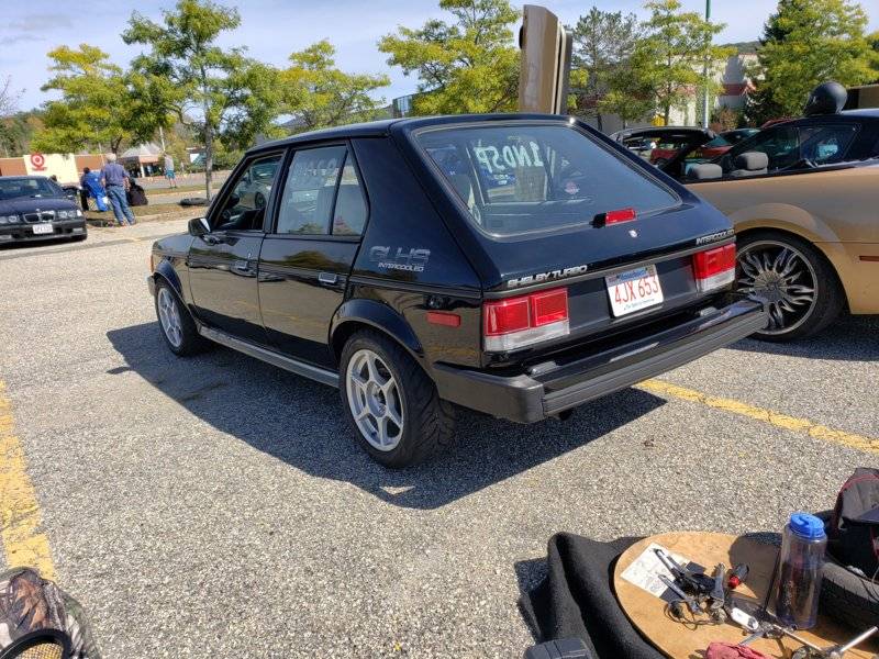

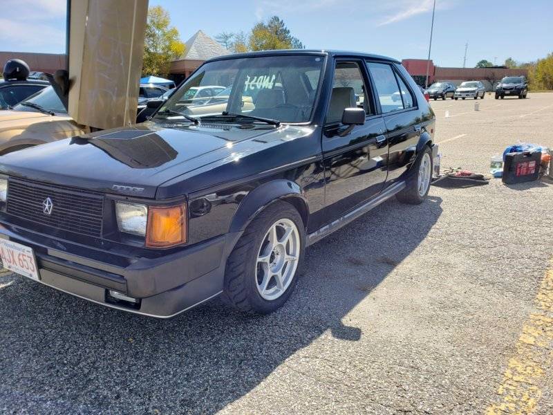

A 1986 Dodge Omni GLHS Shelby I restored/ modified in the 1990's.
But I chickened out and went with a custom flashed chip in a modified socketed computer. These are a few pics after 15 years of storage at her first autocross that happened a month ago.
View attachment 857258 View attachment 857259
