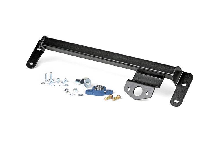

...this is why mine is a 6 speed stick. It got a clutch at 250k miles. woo. hoo. Until Dodge starts using Allison transmissions...I'll keep running my manual transmission till it croaks. I did have to rebuild my front end at 200k. I added the steering box reinforcement, made a YUGE difference. Definitely recommend it.
Steering Box Brace | Dodge 2500/Ram 3500 4WD (2003-2008)
Thanks, I have had that on the truck for a long time.
