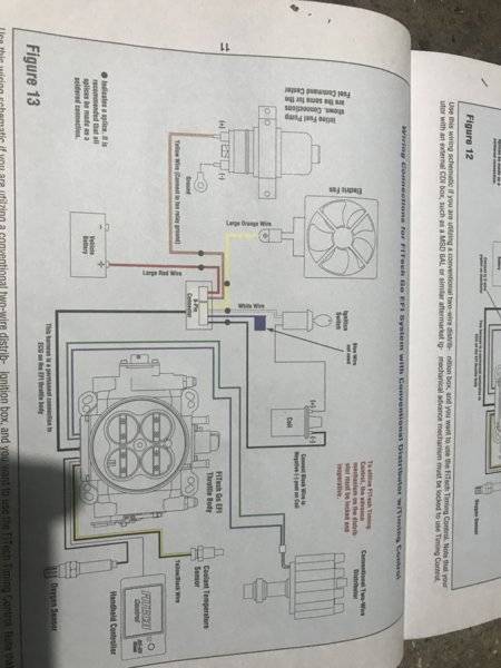

This help?

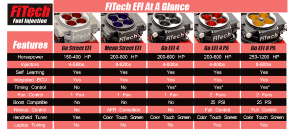

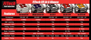

Here are the features of the different models. The power after ( PA ) gives you laptop tuning as well, I think it's the same price. Also controlled 2 fans if you have it..
Snake - Looks like you’d have to change out the distributor to have the fitech control the timing

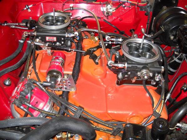

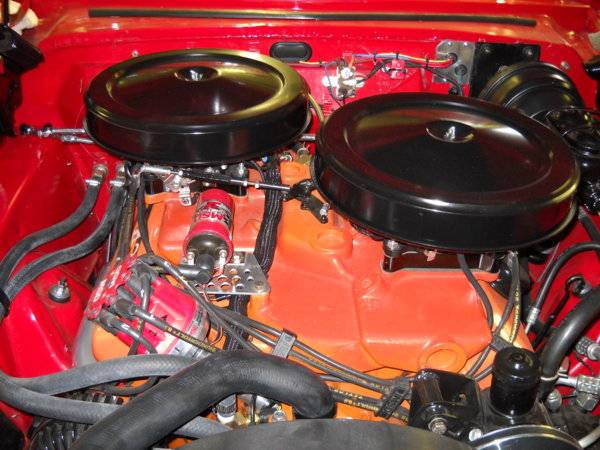

I use an MSD Pro Billet distributor, locked out, with my dual Fitech throttle bodies on a crossram manifold. It's really neat to be able to alter the A/F ratio and timing on the fly.

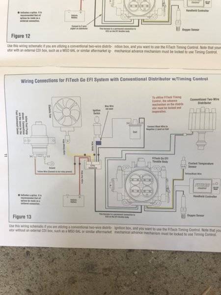

Ht413 does the fitech control spark advance? If so how since I hVe a msd vac distributor and 6al?
Yeah it can control spark. Pretty slick unit. Any 2 wire dizzy can be used, just lock out the advance. I'm not going that route yet but probably will this winter.
It can even control timing and still use a 6AL box, or just eliminate the 6AL and the throttle body acts as it's own traditional electronic ignition.
