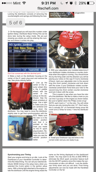

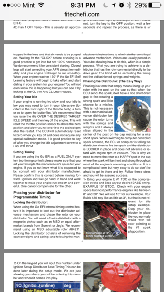

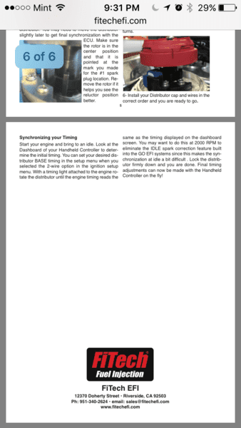

Here's the stuff on setting up timing control - figure I'd just botch the translation :)
Here's the link if the pix suck..
http://fitechefi.com/fitech-uploads/2016/07/QuickStartGuideFinalV5.pdf
Seems like maybe you set base timing and the fitech takes over from there? Too lazy to walk out to the garage and get my manual
Does the advanced timing get set off the controller? I didn’t see any mention of advance in there
Yeah once you set it all up, you use the controller to set the timing advance and RPM it comes in at. The computer then creates the curve, so it acts like a normal dizzy, not just throwing all the advance in in one shot.
Edit: and yeah you set th base timing with the controller as well like you said, 67.

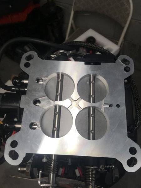

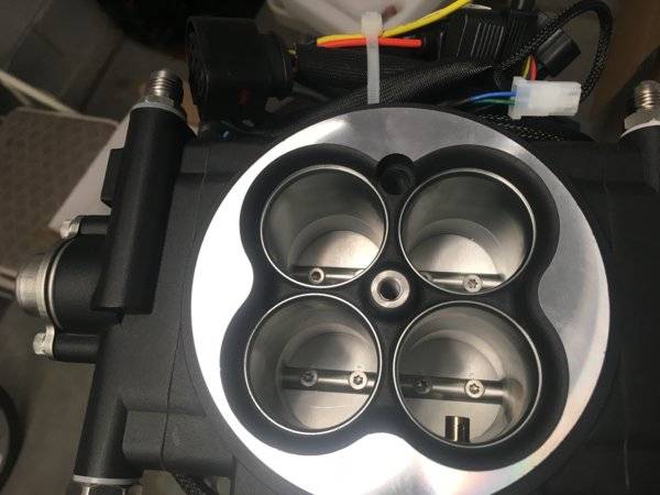

Pulled the trigger a few weeks ago and finally found some time for the install on the 451.
Went with the fitech Go EFI 4 which is a 4 injector 600HP throttle body
View attachment 524357 View attachment 524358

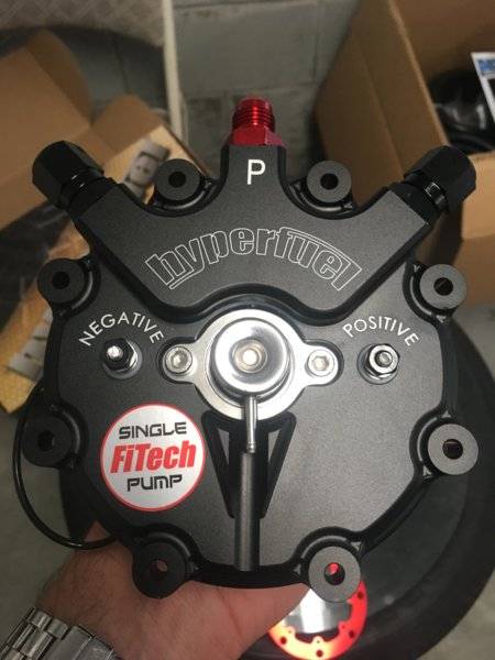

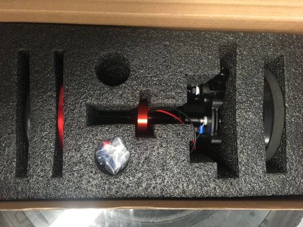

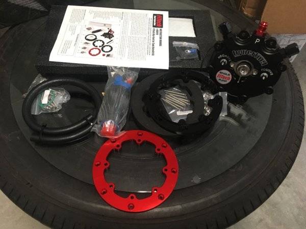

their in-tank kit is as beautiful as the throttle body.
View attachment 524359 View attachment 524360

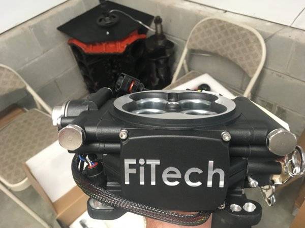

Think she's smiling...
View attachment 524355 View attachment 524361

She RUNS!! Fired right off once I purged the lines set the initial parameters. Didn't get to take it for a drive, but I warmed it up in the driveway. The throttle body is whistling pretty bad and it's idling way high, assuming it's a vac leak but I'm out of starter fluid to check it with - it'll wait for tomorrow.

Glad I went with the in-tank pump - faint noise before startup and can't hear a thing while the car is running.

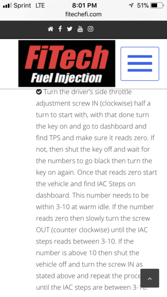

Make sure you adjust the IAC steps, that should take care of the high idle.
