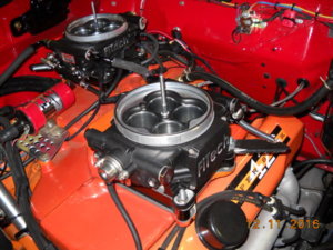

How's about a little fuel injection?

Yeah figured as much. Dave I gotta tell ya, the car is FASTER with the EFI. Much more power up in the RPM range than the 750.

You're gonna love it, mike. I'll tell ya though, between the in-tank pump kit, replumbing the fuel lines, the throttle body and swapping in the flow tech headers, I had 15 hours in the install.

Will a drop base air cleaner fit over the throttle body? They look fat.
I'm using 1/2" aluminum spacers on mine. With AN fittings you need to use a 45* or 90* fittings off the throttle bodies. Straights will hit the base.
