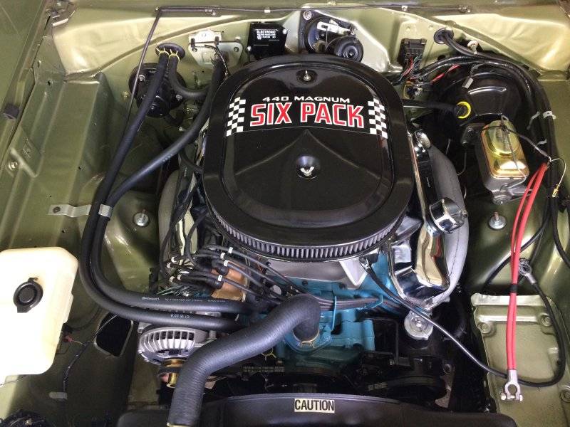

1970 440 SIx Pack, nothing to crazy, on the dyno at 5500 rpm making 425 hp & 530 ft lbs of torque. I've always run original HP manifolds & factory H pipe, full exhaust. Is it worth it to install TTI headers ? Will it boost the horse power & if so by how much roughly ? Thanks in advance.
