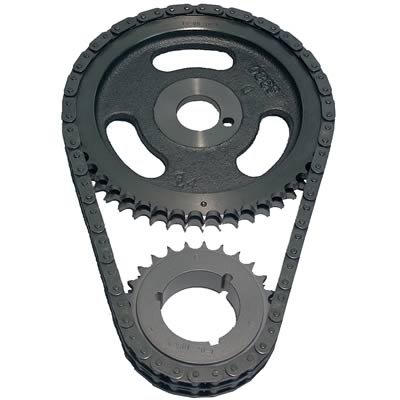

The mystery is solved......There are 3 key ways in the timing set I have, one key has a triangular top, one has a rounded top and one has a square top. The o marks were dead on so I knew that I was ok there. Then I checked the key ways and found that the "Factory" key way is the rounded top, NOT the square top. If you bring up Cloyes web site you will see that the rounded top key way is just about 170 degrees out from the square topped key way when you use the o as the alignment marks. I changed the gear to the rounded top and reassembled the rocker arms and spun it around...NO problems and the valves now move like they are suppose to. Thank you to all....all I am out now is a new timing chain gasket.
