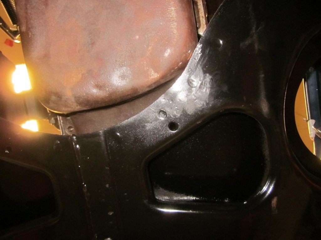

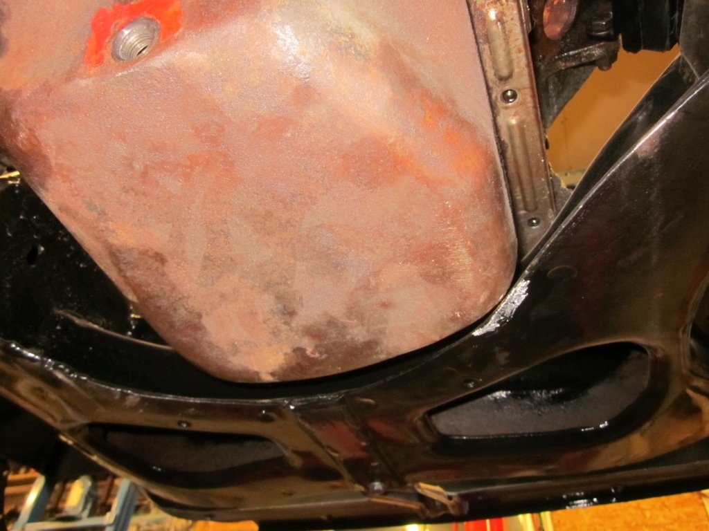

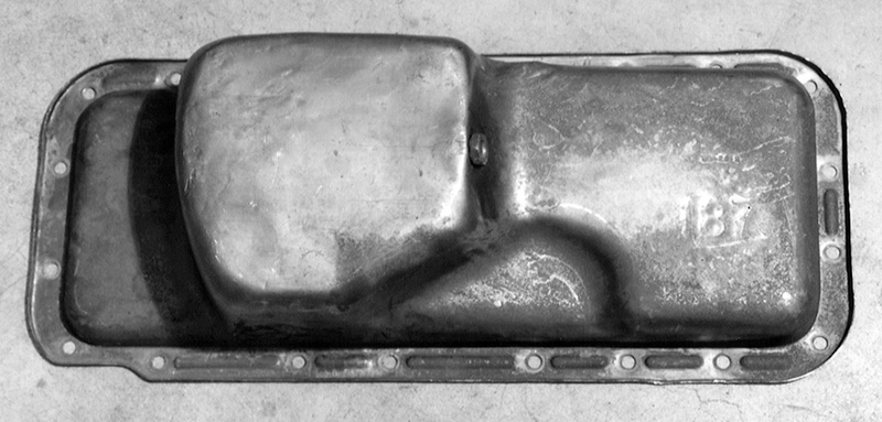

Here's the C body 699 (same as the 187) pan that just fits, although I notched the k-frame a little.
440Source has a similar pan, which is a 6qt, but seems expensive at $249.

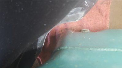

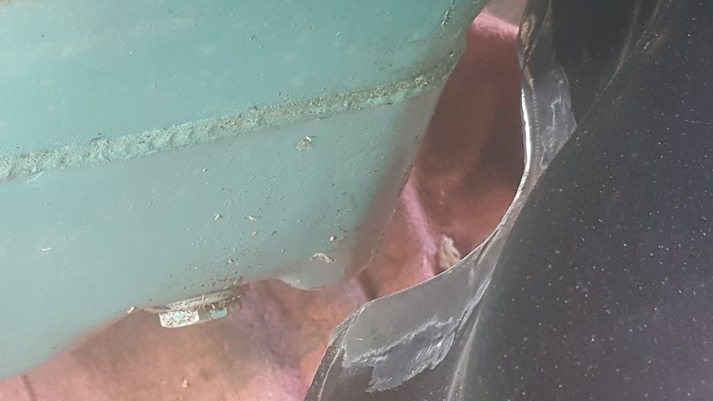

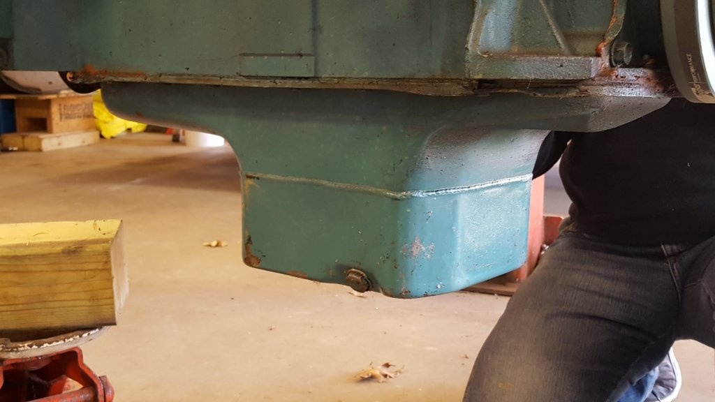

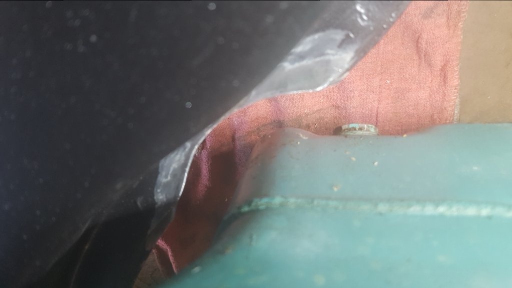

Just an FYI. Its been a long time , 15 years or so, but if my memory serves me correct, the pan I am using is a Moroso 8 qt. Just did a test fit and notching yesterday. I have no Idea if this pan can be had anymore.
The problem with the 4 quart pan will only show up IF you maintain 100 mph for more then 2 minutes. The oil pressure will start falling very quickly and if you do not back down it will fail. The pickup size of 3/8 will work for most engines. If you are running a "stroked" crank, I would change to the 1/2 inch size. The only real issue against the 1/2 inch pickup is it will not fit every pan. It is very easy to change to the 1/2 inch pickup if the motor is apart and can be cleaned after tapping. I myself have used the 6 qt. street hemi pan and have been happy with it, if the pan can fit the car.
This is the pan I was referring to about not using, no offense but I had one on mine and it didn't take long to get scrape marks in it.
