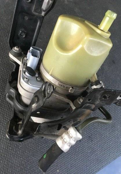

I stumbled on to electric power steering pumps from 04-13 Volvo s40.
Since I am doing a big block swap I plan to use the electric pump and hydroboost because big block will be on a motorplate.

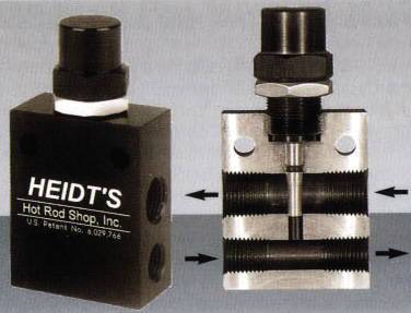

I would like to know if there is a way to adjust the pressure to the booster maybe similar to a brake proportioning valve?? If so one would theoretically be able to “ tune “ the booster pressure to the weight of the car. It’s all hydraulic pressure. Just some food for thought.
You mean like this
Something like that to go on the pressure inlet side between the pump and booster so the pressure can be adjustable. I have not looked up working pressures yet but maybe having working numbers and see what is the difference for different cars and trucks. There must be some formula used to arrive at different level of boost based on weight or type of vehicle right? I am just thinking really loud. Thoughts?

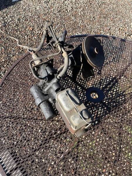

If nothing else, I know the pump was working with the HB, and that it was bolted to a 440. May not be much else that is relevant or useful since it was all on a Winnebago.
