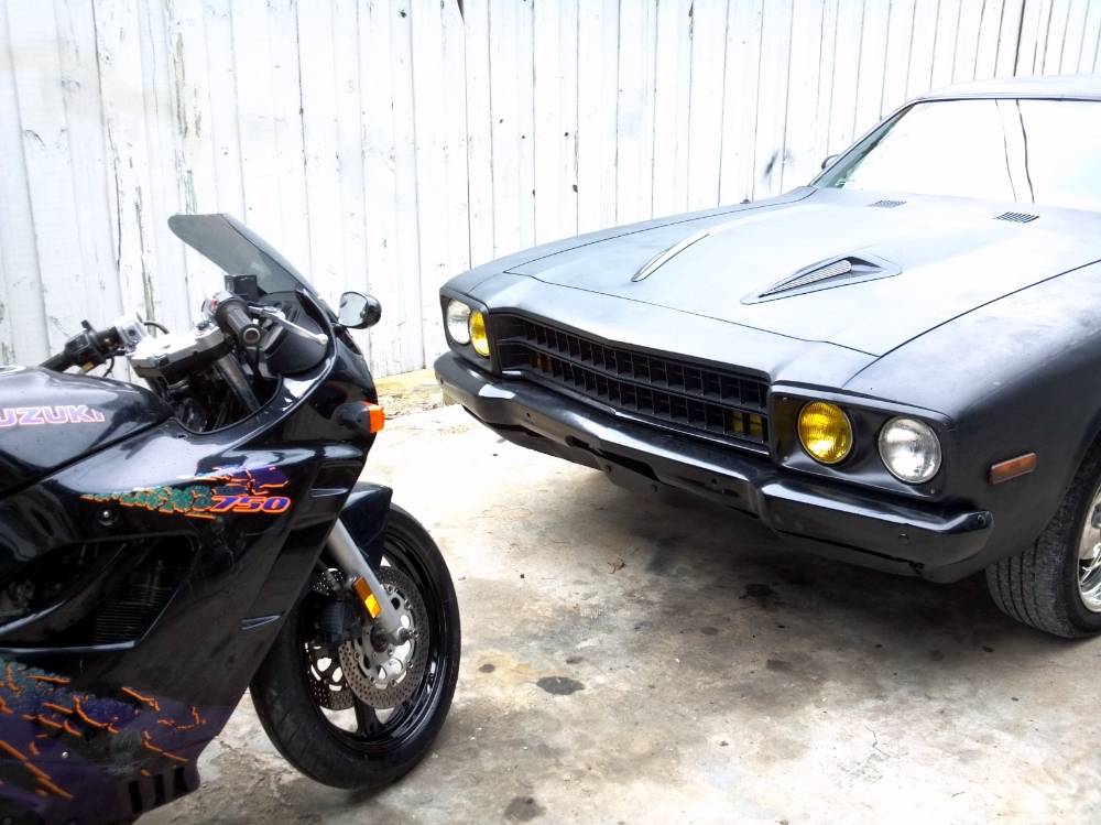

In other news...A mopar and a suzuki go head to head
Although the the Suzuki would win, I would still want the MoPar.
