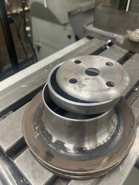

I needed a smaller pulley with more offset for something I'm putting together..

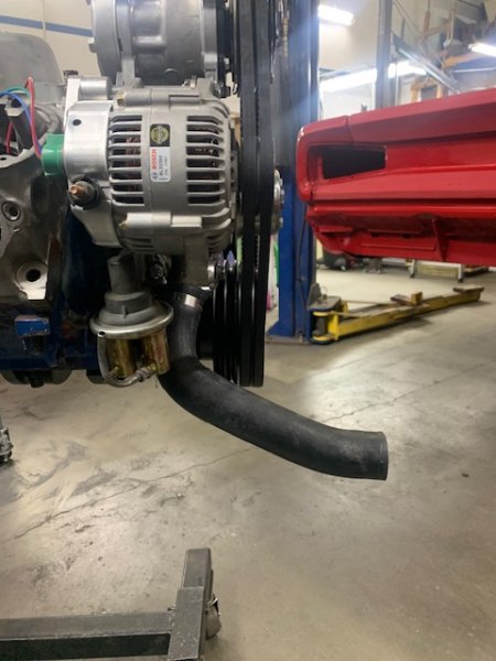

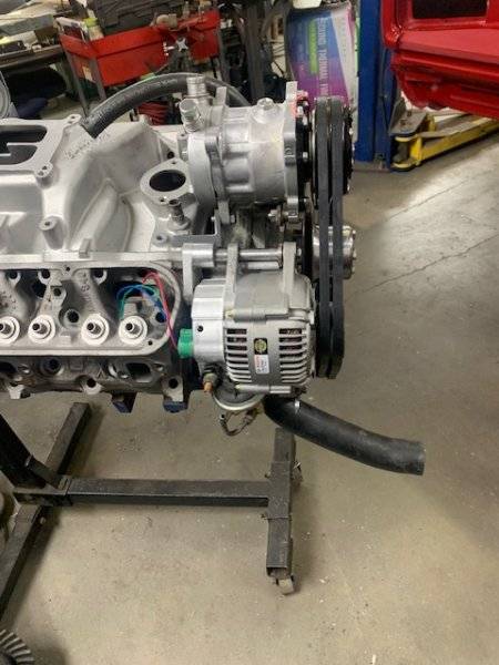

LA I'm changing some things around on the Red vert... Replacing the RV2 with a Sanden & replacing the stock alternator with a 120 A Denso off a Landcruiser...

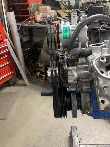

I've done a Sanden in place of the RV2 on a small block before using the Bouchilion brackets & to be blunt, they suck.... Running the A/C & the alternator both with a single belt means the belt starts slipping any time the load increases.... When does the load increase? When the A/C head pressure goes up... When does the A/C head pressure go up? When it's hot outside.... When do you really want the A/C to work well? When it's hot outside.... Yeah, not a great plan...
My solution.... I'm using a bunch of stuff that never lived together but with a little custom work I'll have dual belts on the A/C-Alt & Crank... And a single belt on the W/P-P/S & crank.... Pictures soon...

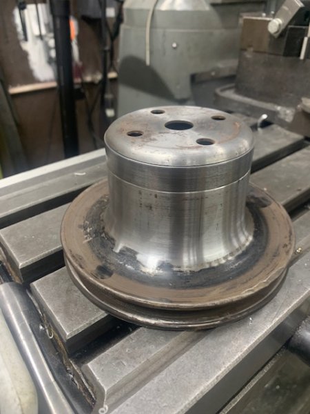

Gotta admit, I didn't expect to have to section a pulley... I figured something was gonna fit...Nope...
I have done this a few times. Of course you need a lathe & not everybody has one [ or a 'favourite' friend ] that has one......
Yeah, I got that covered pretty well, wish I'd jumped in years ago.. Great thing to have access to..
It worked out well for me...

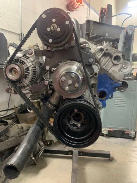

Belt alignment is pretty good, won't finalize the P/S till I take the car apart... I have spare big block pullies & brackets but no small black power steering pump stuff...
Looks like the stock parts are going to locate the pump about .40 to far forward... Gonna have to make a new rear mounting bracket...
Belt alignment is pretty good, won't finalize the P/S till I take the car apart... I have spare beg block pullies & brackets but no small black power steering pump stuff...
View attachment 1559430View attachment 1559431View attachment 1559432View attachment 1559433

I already have V belt pullies... I had to modify the alternator pulley but I didn't have to make or buy it... The A/C compressor also was a V belt design real Sanden (not a Chinese knockoff) & I got it years ago NIB for cheap... So no, not gonna bother with a serpentine system... Honestly Serpentine systems look to modern on old cars IMO... It's bad enough using a non-OE Alternator & Compressor but I care about reliable more than OE...

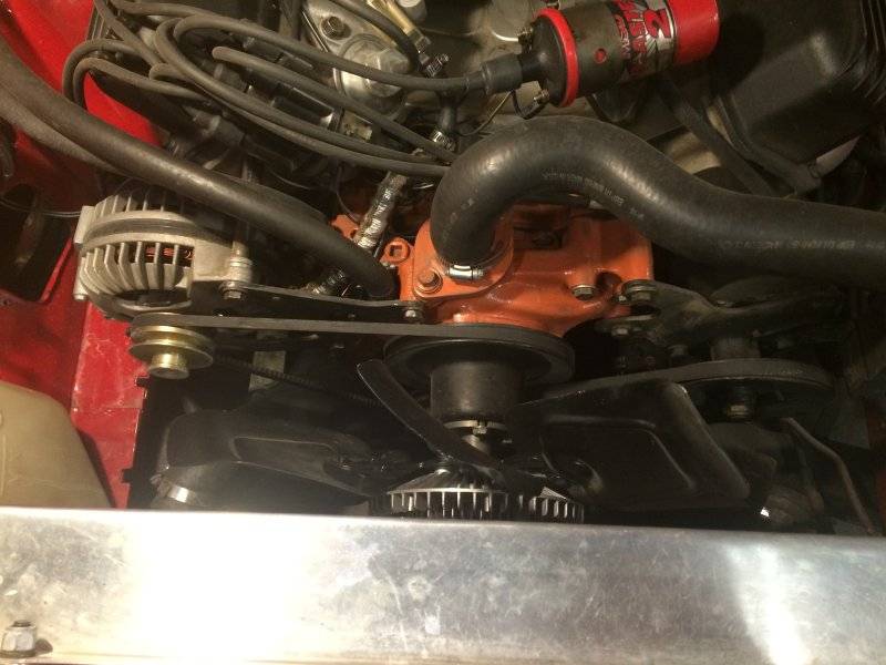

Got my belts aligned about as close as I can now.....hopefully no more jumping off under high RPM's.....
Changed the dual groove to a single groove alternator......much easier to align now. :thumbsup:
Kiwi,
Your alt groove does not seem wide enough for that belt, could be why it is throwing belts....
