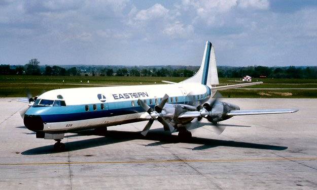

Once upon a time, Lockheed built a lot of passenger planes. They developed the first American turbo-prop liner, the L-188 Electra. With exceptional short field take-off abilities, the speedy plane was popular and airlines started ordering in quantity.
Then three of them crashed, and a design flaw was discovered. After the problem was fixed, confidence was shaken and no passenger airline ever ordered another one.
