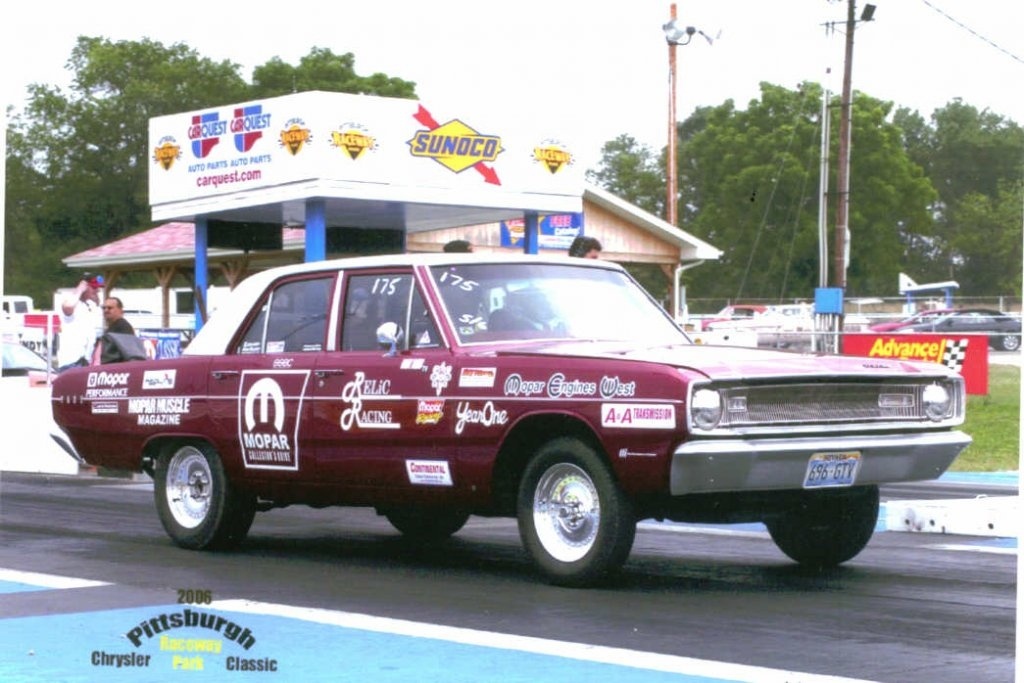

I feel each car has it's own "Likes".A close watch of the time slips and recording the different temps during a test and tune event you should find a optimum. For years I raced a Slant Six car that liked a starting line temp of 175/180*. I ran a manual switch for the fan/water pump to get it just right when staging.Any more or less the car would run slower.I even made a sign for the dash to do the same process from warm up to burnout box to the stage lights.This just kept the car consistent for bracket racing.I would dread any delay from the track personal to keep me from hitting my goal,,,but hey "That's Racing"
