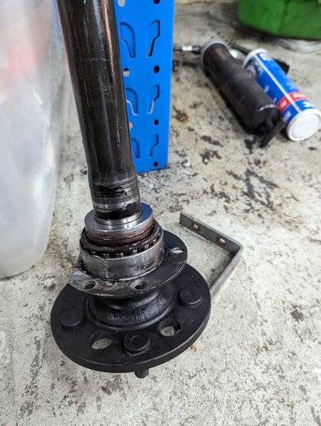

I just pulled the rear end to change diff gear ratio. Forgive my ignorance but these look like green bearings? Do I need to do end play adjustment on these bearings?
Thanks for your help
That is a stock type tapered bearing and will need to be adjusted after reinstalling. I hope for your sake, the other axle has the adjuster since that one does not.
Thanks Kern. I assume I will have to buy the dial and jig for it. Is there a backyard way or adjusting the play with feeler gauges or other?
With out a dial indicator, a fixture could be rigged up (make it adjustable) to allow feeler gauges to be placed between it and the axle flange. Tap/rotate the adjuster nut with a punch/old screwdriver to obtain the clearance you desire. A dead-blow hammer works well to move the axles back and forth/in and out. The adjuster flange belongs on the right side of the axle assy. In most applications, tapered roller bearings need a slight amount of clearance. Like the front wheel bearings.

I have never used a dial indicator to adjust axle bearings. As strange as it may seem to some people, you can develop a feel for the right amount. I've never had a failure as a result of using this method.
I adjust mine by feel as well. I get it to zero play and tap the hub with a dead blow to set the bearings and readjust to where there is just a bit of play.
Keep the taper bearings, they are built to last and adjustment is very easy.
Spot On... I turned wrenches for 40 years, Easy peasy... Run the adjuster down till there's zero enf play, back the adjuster off two notches.. There should be a very slight amount of movement.. About 010....

In a stock rear axle green bearings are not your friend. They suck!
You guys need to stop hitting the axles with a hammer. It is not helping anything. it says lightly tap With a non metallic hammer.
