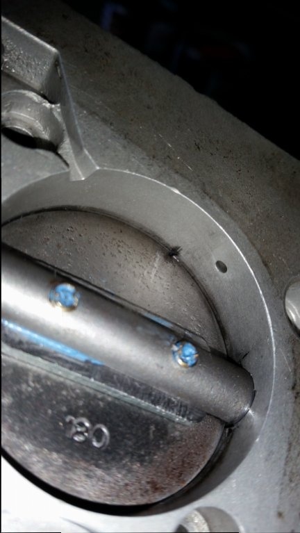

When i expose my t-slots i get bigger gap at the throttle-blades, it must be that the bigger gaps give me to much air?
Maybe my Throttle-blades is to worn?
Would a picture of the gaps help?

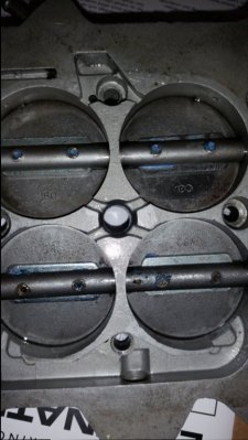

Took out all blades and tried to readjust them for less gap, but if they are not adjusted correctly and i bolt on the carb the blades are getting stuck when open the throttle.
So i don't think i can readjust them in any other way.
I do not think they are to worn either, the blades on secondaries look much newer but when i measured them i can't see any difference in size.

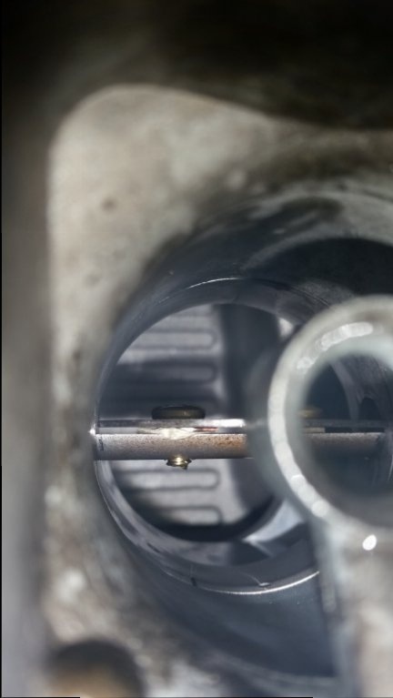

An idea i had was to add a small bushing between the throttle-blades and shaft, it should have the same effect as bevel the blades?
I misunderstood and thought the blade was above the slot. I guess you have looked for any possible vacuum leaks. Throttle shafts can wear and leak air but I wouldn't guess your carb has that much use on it.

I took a small bushing and did my own small gasket with milk carton and put between shaft and blades.
When this was done i could expose t-slot without having to much throttle-opening , turned inital up to 14 and idle mix to 13-14 afr.
Result, tip in problem gone!
Rpm is still a bit to high, 1000-1100 and slow return to idle is also there.
Hesitation on WOT did not change, same problem.

As seen in the picture, only bevel the blades would not helped me enough.
Maybe bevel the blades with this gap make the magic, the question is how the gap affects the air/fuel going throught it.
