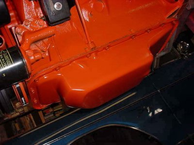

If you use your original K frame you'll also need a 65 or earlier oil pan or one with 5" from front of pan to beginning of sump.
1. Schumacher mounts on factory V8 K-frame
2. Hedman 78030 headers fit perfect.
3. Deep sump pans like the one from 440 source fit fine but you'll need to notch the k frame on the right side. Not a big deal at all.
