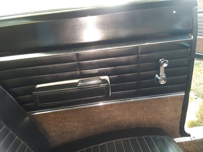

I’m out and about. Will check later to see.Yes, those look like '67 window cranks to me.
Are the plastic washers present between them and the door panels?
I've also very recently learned (thanks FBBO) that 66/67 Chargers had different regulators with longer crank pins because of the increased thickness of the Charger door panel vs the Coronet/Plymouth panels.
Do the rear cranks rub?
Is it possible someone used Coronet/Plymouth regulators during the restore?
The reason I ask is because simply using 67 cranks in a 66 car shouldn't cause rubbing or they would have rubbed in 67 cars.
...unless the 67 door panel is different to compensate.

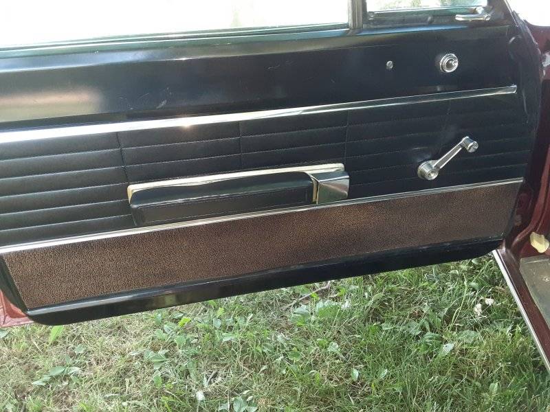

Yes, those are '66 cranks, They resemble the ones in my '64 Polara, which is correct. I have a '67 R/T with different, simpler cranks.Okay, so I’m back at it.

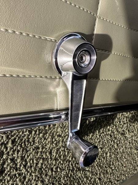

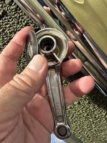

Yes, the fronts rub only on the chrome trim but I can pull the crank away from it (for the most part) as I crank it over the trim. Less than ideal.
Yes, there are very thin black plastic washers but don’t know that they actually do anything to help. Curious if I can just space the front cranks out just a touch by adding washers. There’s still lots of thread to hold the cranks on firmly…
No, the rears are fine. No rubbing.View attachment 1407218View attachment 1407219
Yes, the wrong components could have been used in the restoration but I have zero history on the car. I bought it as is at Mecum Auctions.

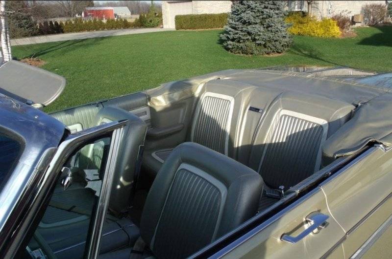

Perfect! That’s what I was trying to find.So, your Coronet would be gold with gold interior, to the casual observer.
Yeah, that was never a thought!I am not trying to beat up your car, since it looks to be very nice, especially in that colour combo. The only things that really look out of place are the colours of your console and dash.
The 66-7 Charger arm rests look the same, also 66-7 Coronets that I have seen.I don't think your dash and console colours are correct. They are too green. On my '64, the lower dash metal was the same colour as exterior sheet metal, same as your metal door uppers. I would think your seat upholstery is correct, since they are likely Legendary pieces, and they are usually spot on with colour. It may be the lighting, but the exterior colour looks like the Anniversary Gold on my '64, kind of a champagne hue. I remember the '66 and '67 gold as having a green tint to it. Your headliner should be a close match to the colour of the seat material, same with your dash pad and console. The top of your dash might be a semi-gloss Olive colour. Based on posts on another thread, your arm rests look to be 1967 and newer, the only ones currently reproduced.
Your engine looks to have '67 and newer HP exhaust manifolds. 1966 air cleaners would not have a pie plate. They first appeared in 1967. 1966 air cleaner on 383 4-barrel motor would be a small round affair, almost like a slant six one. 1967 383 4-barrel air cleaner would have a tall top that would not accept a pie plate, and two round snorkels.
I am not trying to beat up your car, since it looks to be very nice, especially in that colour combo. The only things that really look out of place are the colours of your console and dash. Someone talented with an air brush may be able to repaint your dash without having to remove it (and windshield). The console is easily removed and can be dyed using SEM dye with appropriate primer. The engine stuff; if you are happy with it, just leave it alone and enjoy it. Most people will not notice the details anyway.
