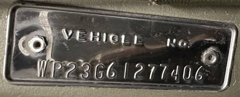

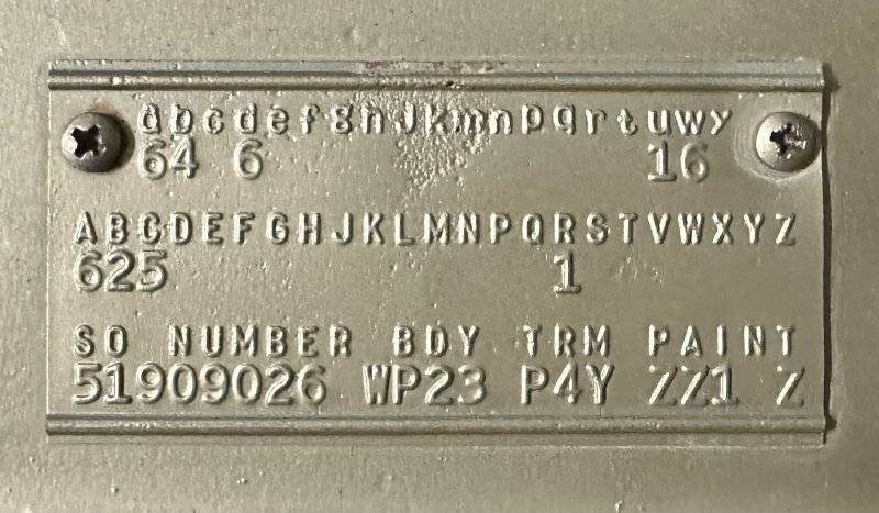

I’ve found several different sites reading the various threads on the topic of decoding VINs and fender tags but I haven’t found one yet that works great for 66 B bodies.
Are there any good sites for 66s?
Here’s the VIN:
Here’s the fender tag:

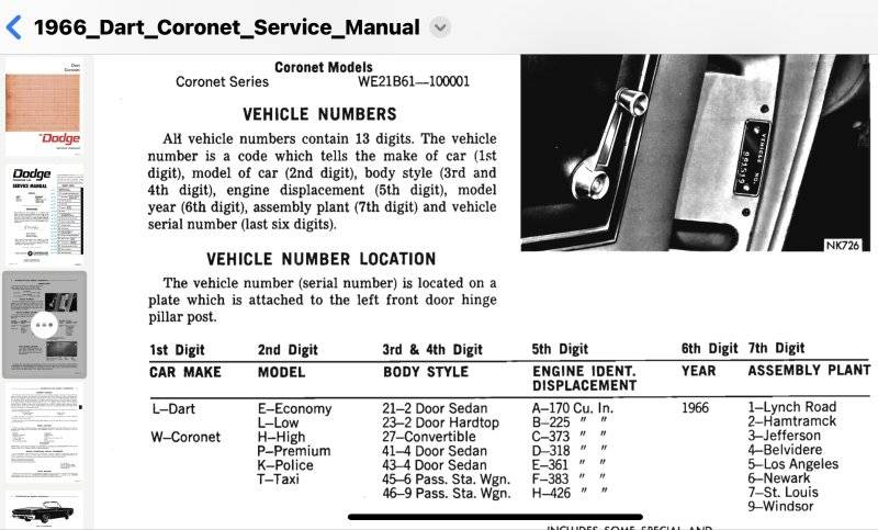

And here’s from the 66 Dodge Dart and Coronet Service Manual:
If I decode the VIN from the service manual I discover that everything makes sense except for the engine size as they don’t list a “G” as an engine option. My guess is that the manual had to be updated at some point and the one I find at MyMopar.com just isn’t an updated version??
