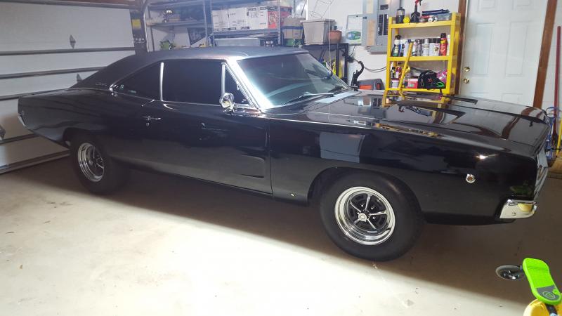

Jason's 68 charger.....sweeter than yoohoo

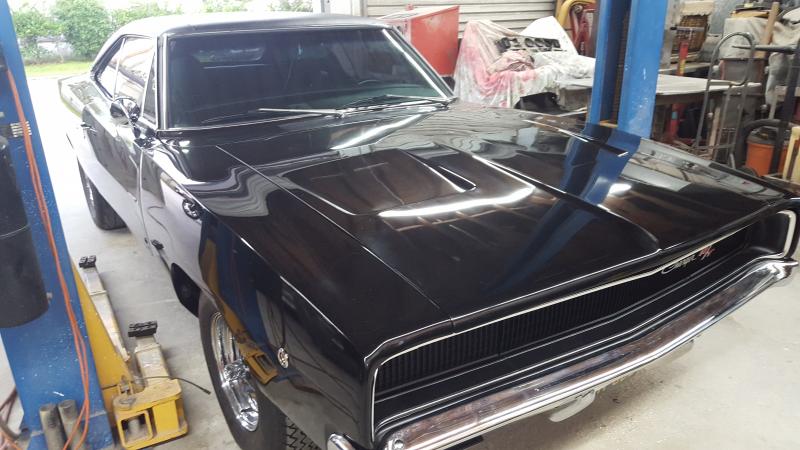

bath time
had to schedule an appt at the alignment place after setting the ride height. but its all done and ready for showtime...
i am getting the final kinks out now like rechecking all the grounds, minor paint touches, E-brake cable adjustment, washer spray outlet tube setting.....
rides smooth, temp is 175-180 just ridin around and the TREMEC is like a dream short throw shifting....ill admit that the reverse location is gonna have to take some getting used to from the A833

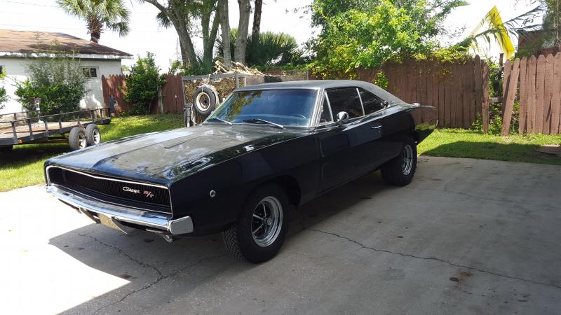

as soon as its clean, immaculate and lookin killer ill get some REALLY good pics and put them up on my day off....gonna be a while tho, gettin to the busy season here...
Awesome! Another Charger rescued and back on the road....... Great job, car looks great!
Great work, that sure is a fine car.

Car looks great - you must be excited. Congratulations!
Now to have some fun, work out some bugs and DRIVE it!
