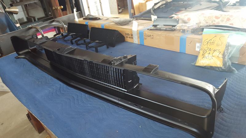

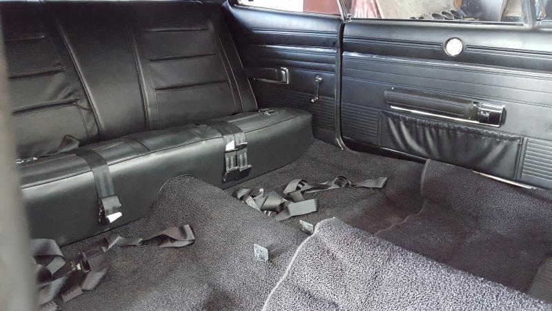

Reproduction door panels, what a pain in the *** these things were. the little pop outs for the clips on the back side werent cut out so it took a couple of days of trial and error of getting them on

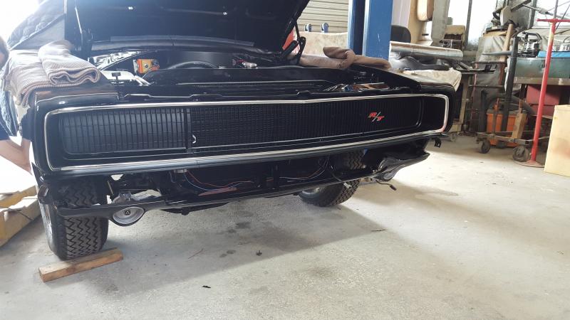

I have a video of the electric headlight doors working but I don't know how to put a video into this thread

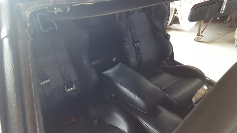

those are home made brackets for the buddy seat sticking up, apparently nobody makes those

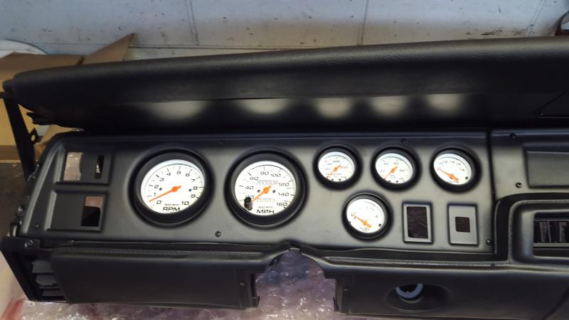

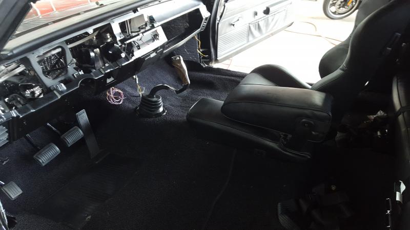

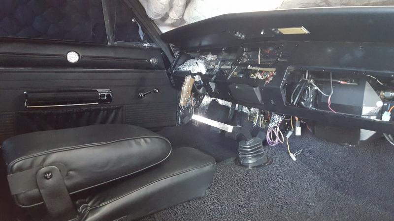

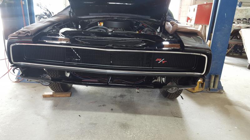

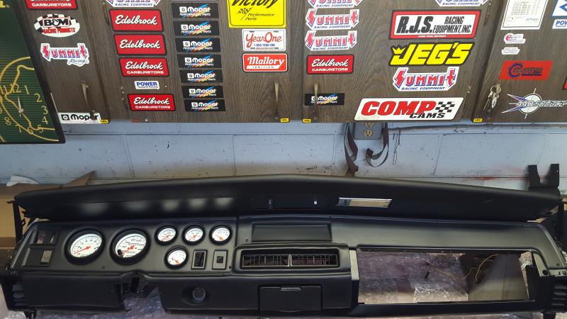

Trying to fit the radio/wiring in today....the factory wiring is mostly useless cause of the gauges and ac being separate systems now, had a custom alternator made to handle all of it and switched to LED lighting to help out
Waitin on some dash parts and the final wiring before the windshield goes back in, then its off to the alignment shop
I cut the decklid to fit 6x9's and bought a new deck that can do BT, sirius and pandora. I also have a hidden under dash antenna so i didnt have to drill a hole in my new fender
