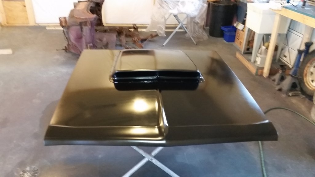

Hood is done!
Cool, can't wait to see it on the car.

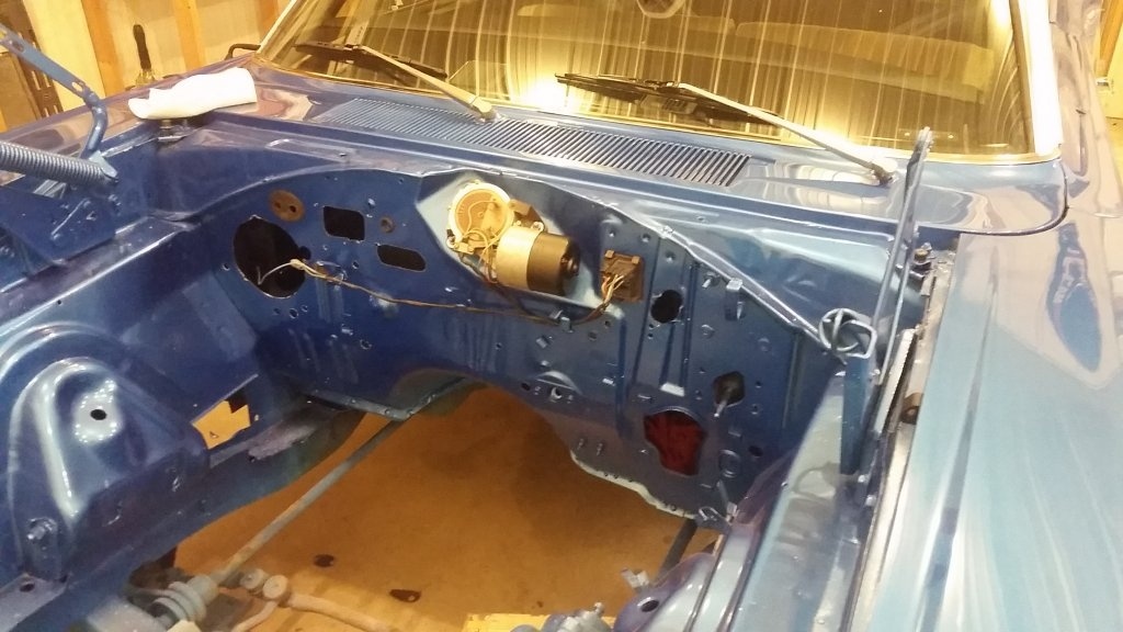

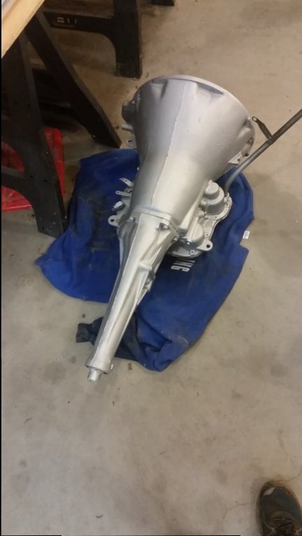

Ok it's been another week, couple more updates. Tranny is back from the doctor, painted and ready for install. Just need to pick up a flex plate and torque converter. Bench tested the wiper motor, all checks out good. Went ahead and installed wiper motor and wipers. I picked up motor mounts, isolators, and a tranny mount at the swap meet. Disc brake conversion kit is ordered. Once that is installed, motor and tranny are going in.

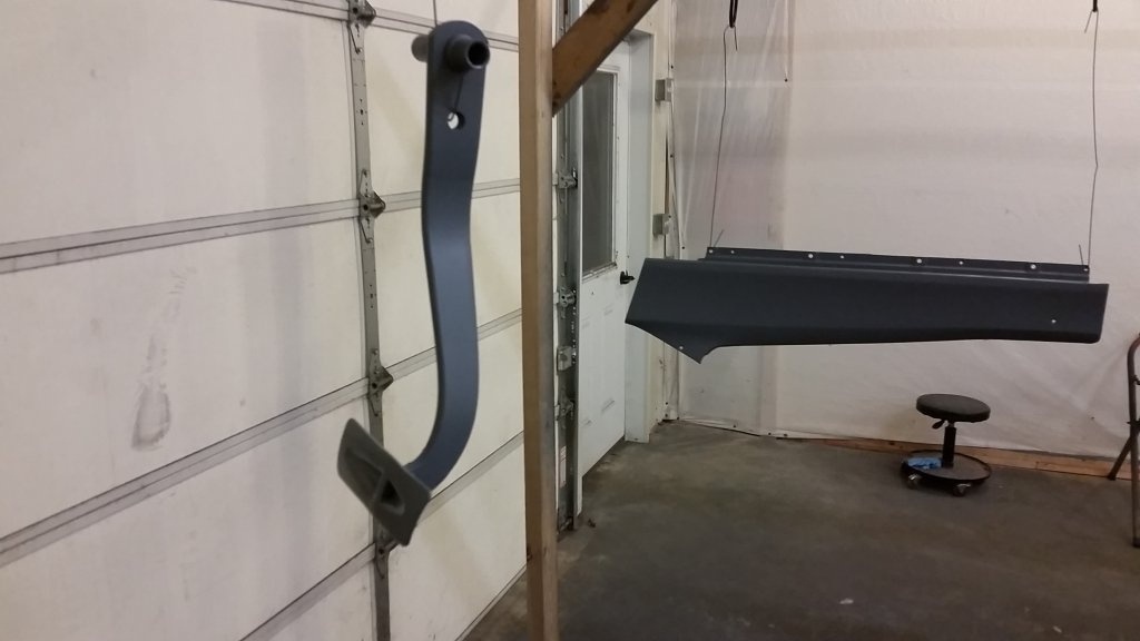

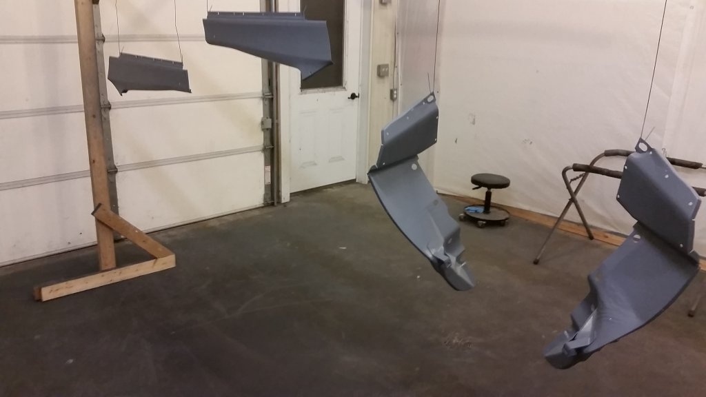

Tonight's project shooting epoxy on the final pieces. I am hoping to finish painting this weekend, so I can tear down this paint booth. I want my shop back so I can finish assembly on this project.
What are you talking about done painting? That K-Frame, steering linkage and torsion bars need restoring and painting :)
You are correct. I will just hang those outside to paint. The bug population has decreased rapidly with the frost we ha the other night. Surprisingly, the front end components on this car appear to be in good condition.
