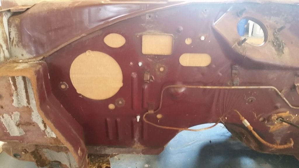

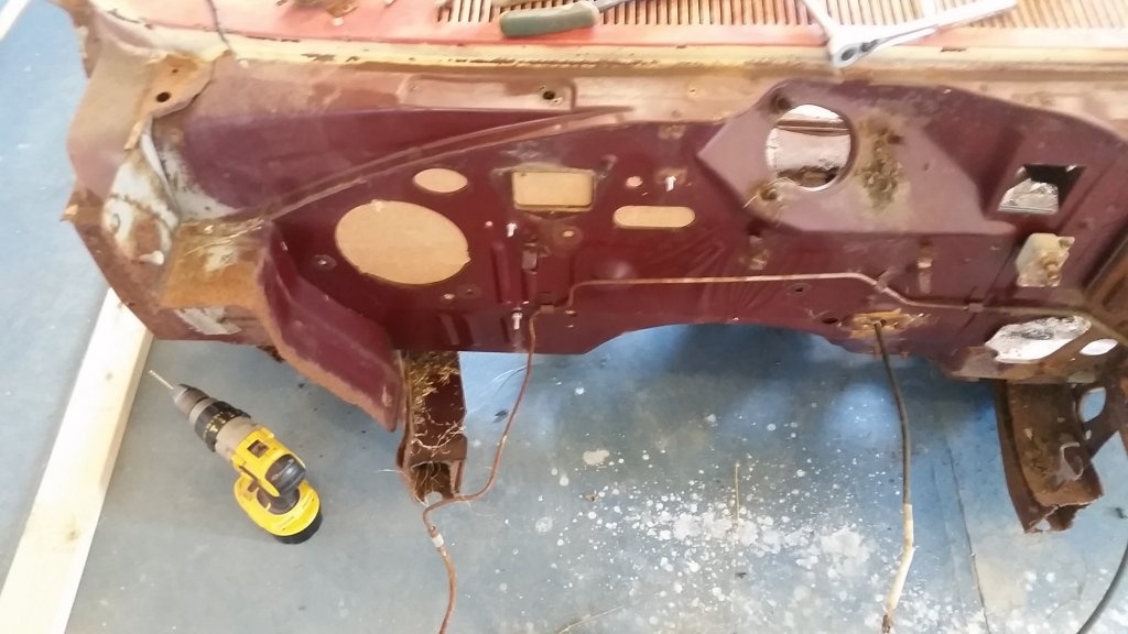

Ok so I have come across a small hurdle in the build. This car is made from combining 2 cars. One was complete, but to far gone. The other, the one I restored, was just a rolling shell. No doors, fenders, trunk lid, or interior. The car that was too far gone had good doors, hood, fenders, and interior. Most of the exterior trim was shot, but that's for another day. Here is the hurdle. The car I am restoring is a non AC car. The one I have all the parts for was an AC car. I am to far in to cut a ton of holes in the fire wall. I am in need of a AC heater box! Not worried about the dash. A couple of non functional vents doesn't bother me.
Sorry, I am in need of a NON AC heater box and controls! I have an AC heater box I would be willing to trade, or I will buy the non AC box outright.

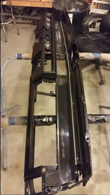

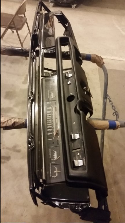

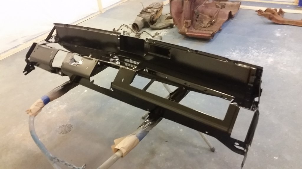

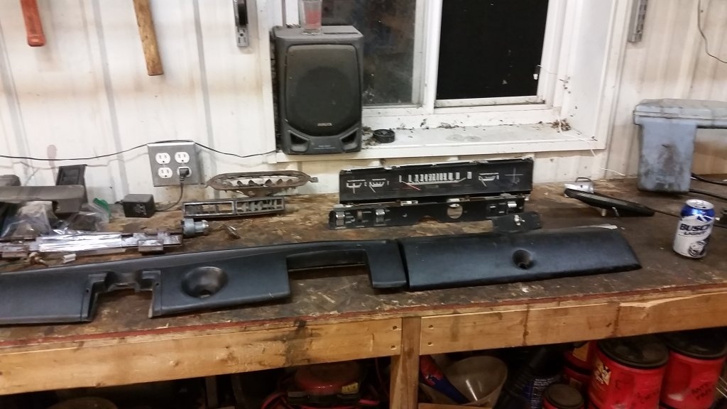

As far as progress, I have the dash sanded, shot with epoxy and low gloss black. Turned out nice.
Starting to dig out the rest of the dash components. Turns out I need a dimmer switch also. Guess I have some shopping to do. Words of wisdom, if you are going to tear apart a car to be restored, bag and label everything. Really wish I would have done that 16 years ago. I have definitely learned my leason. Sandwich bags and sharpies are my best friend in the shop now.

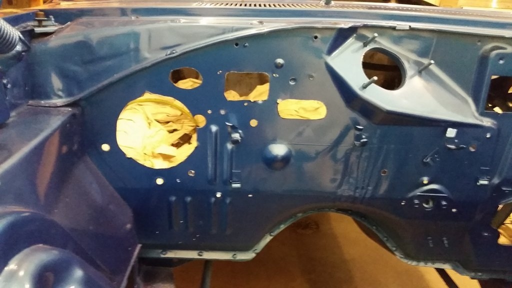

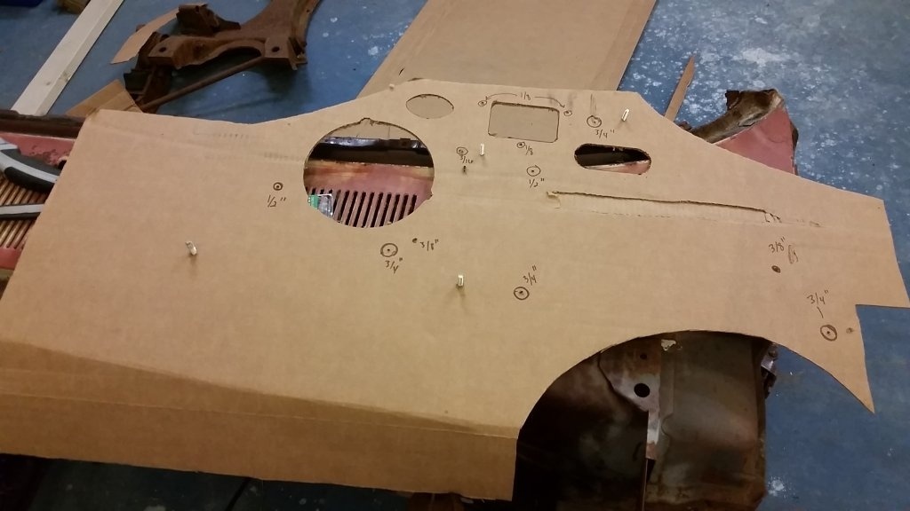

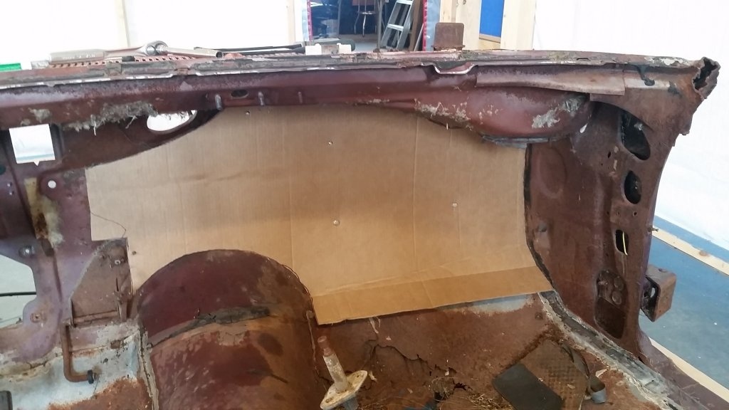

So I have made a decision. Already balls deep into this restoration, so why not go for it. I'm turning a non AC car into a factory AC car. Getting a template made up. Measured and found a couple of bolt holes that line up between the two firewalls. Got everything marked on cardboard after kids go to bed will transfer and start cutting.
The template lined up perfect in the car. With a little help from the air saw and a step bit, we now have a factory AC car!
Wow, you work fast. Looks good. You can get factory air parts from those A/C companies I mentioned before.
