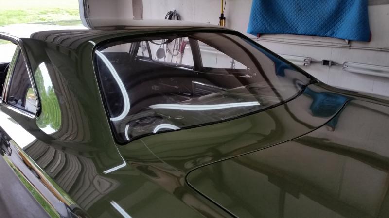

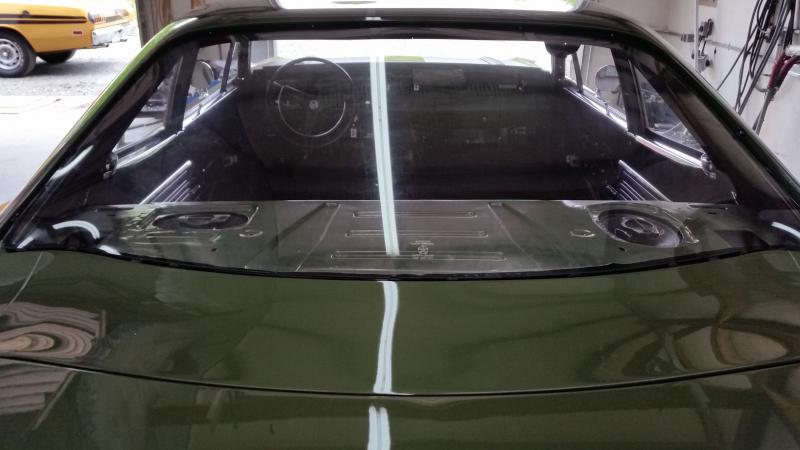

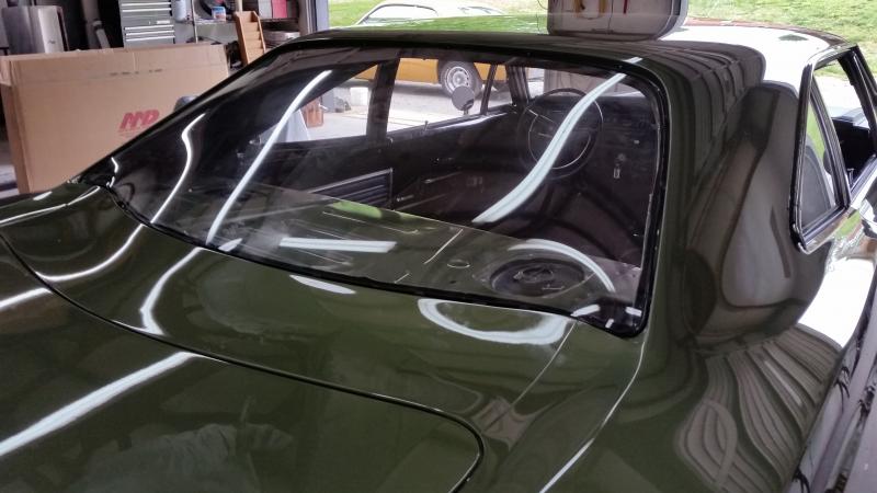

Dried in....

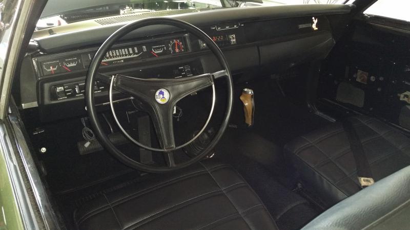

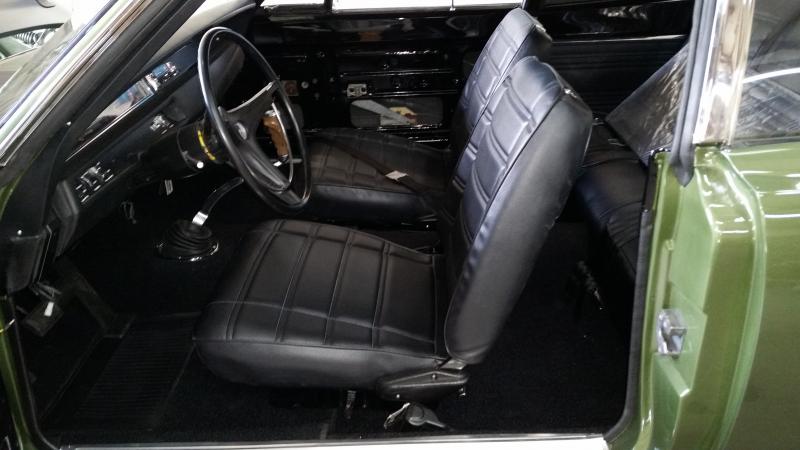

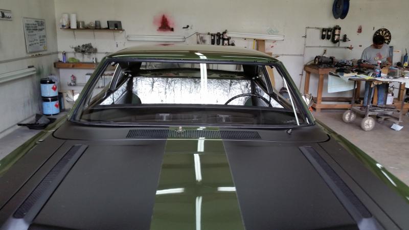

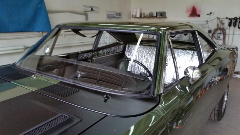

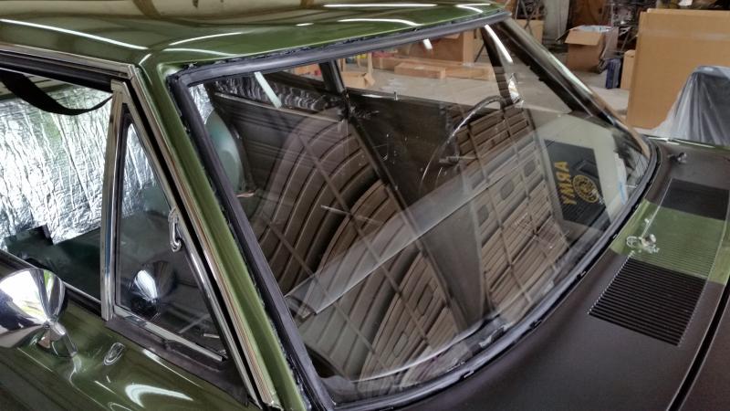

where did you find that windshield moulding piece? is it one piece or two seperate pieces? thanks

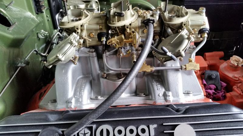

Ahhhh, is the carbs bowl vent hose supposed too attach to the oil breather vent? or is oil breather vent hose supposed to attach too the carbs base plate?
I'm not sure if I understand, I have not installed the moulding yet, so I think what you are seeing is the windshield boot/seal.
Awesome, I went back and looked at the picture in question, I laughed. it's either an optical or typical dilusion, or contusion, or something else. I can assure you that the bowl vent is not hooked up to the pcv port. but it certainly appears to don't it. Good eye.

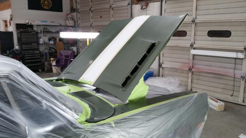

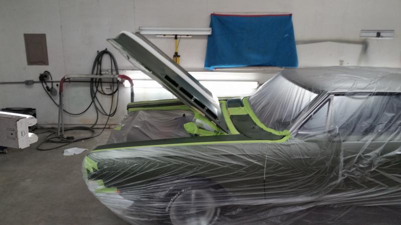

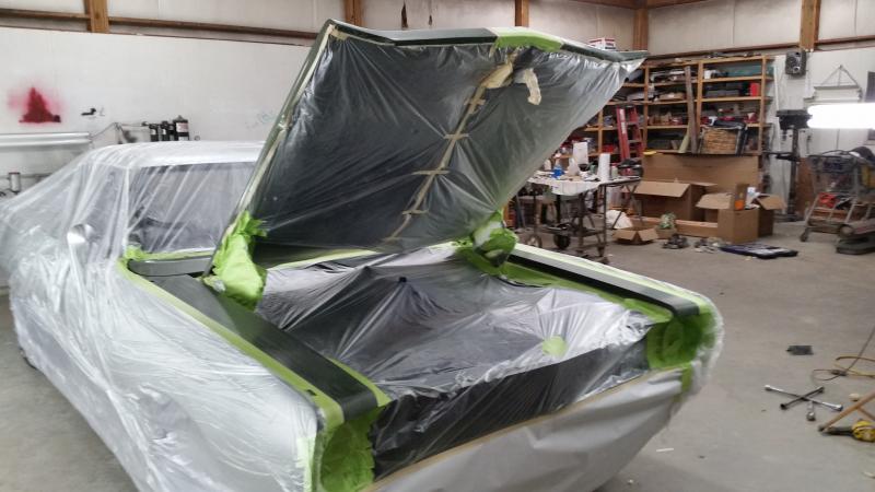

We are about to go to paint on my car and will be putting on the hood stripes in the next week or so...how far does should black go onto the inner fender - is it just the overspray, or something more?
I masked out so that I could close the hood after the inside stuff flashed off. you can see the edge on the cowl, probably 5/16" in on the horizontal. I also went over the inner fender lip to the edge of the horizontal. the entire edge of the hood is also black, under the front lip and, the rear edge. the idea is to look into the gap, and see only the same black. as to the overspray into the edges, I highly recommend that you do not. the reason that the process I'm using works well is that with the jamb paint only flashed and not cured in, anything that goes into the edge while spraying the outside, will blend in and for all intents and purposes, disappear. the hardest part is the masking. try to set it up so that you can remove the hinge masking and close the hood without hitting the masking on the cut in area. good luck.
