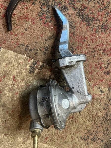

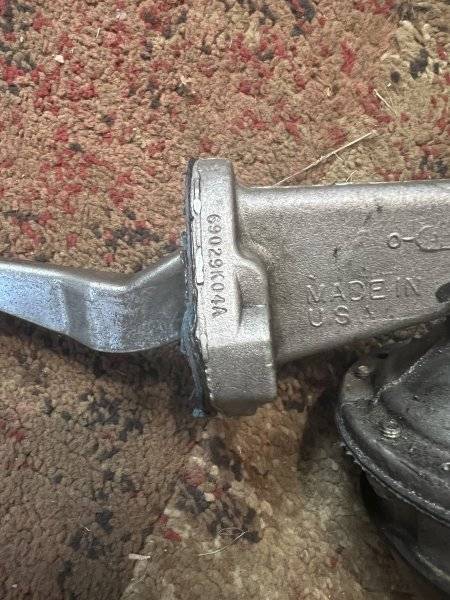

I think it might be the fuel pump all. For the life of me I can’t find a replacement to the below Carter online anywhere. Do those numbers mean anything to anyone? I bought a cheap replacement just to see and it seems to suck fuel but isn’t fitting flush. The engine is a 360.
69029K04A

If it matches up to your old one, try turning the engine so the eccentric on the timing gear is farther away.
Hold the pump in place and use a remote button hooked to your starter relay to bump the starter. You'll feel the pump getting closer.

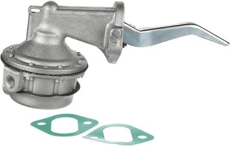

Pump lever on your new pump looks longer after the bend. If you put pump flanges next to each other are the levers the same length?
If you end up needing a new pump,​
Fits 1964-91 Sb Mopar Dodge La Hi Flow Fuel Pump 273 318 340 360, but there are cheaper units available.​

Just wanted to update and let anyone that finds the thread know it was the pump. Lots of good tips here if it wasn’t. Can’t believe the coincidence of the pump failing but maybe it ran dry for a second and was damaged or just really at the end of its life.
