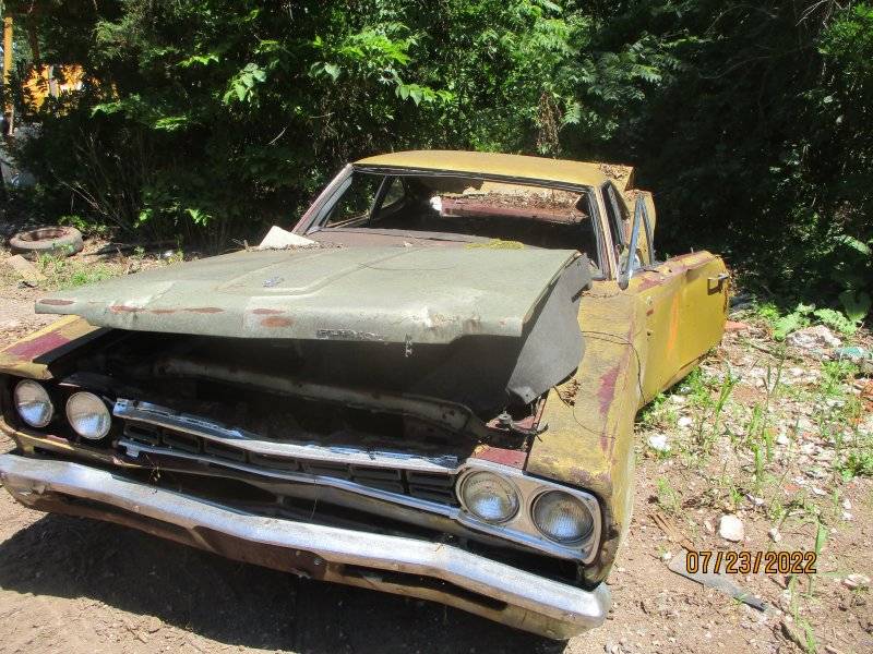

Just saved this 68 Road Runner 4 speed from the crusher. Any way to tell by the sales order number when it was made (month)

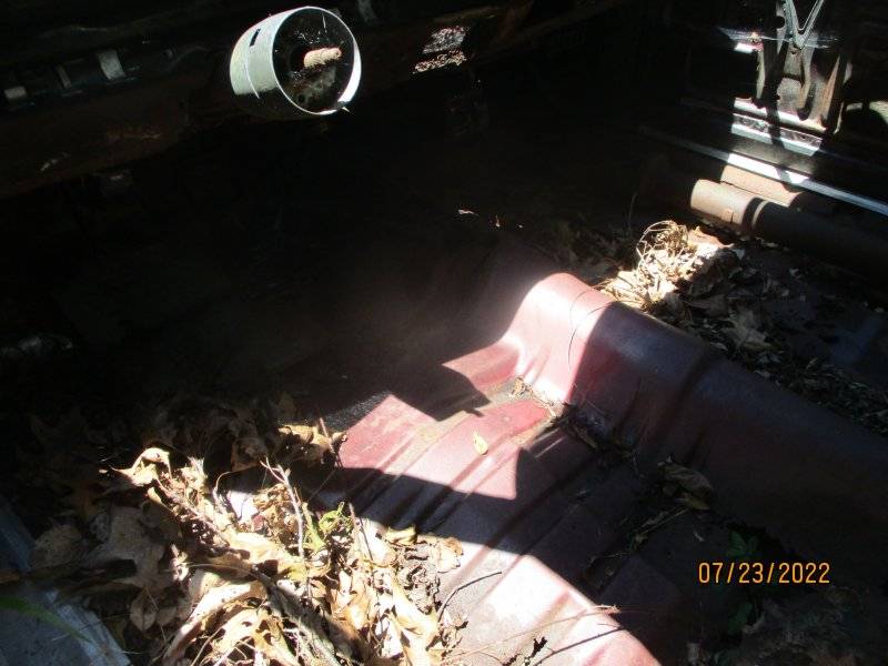

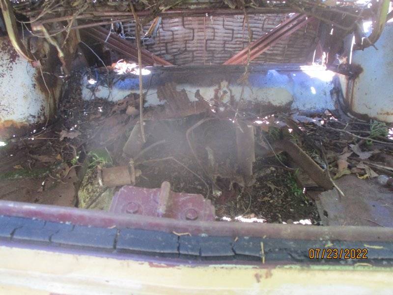

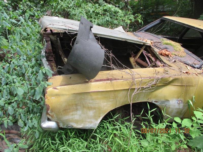

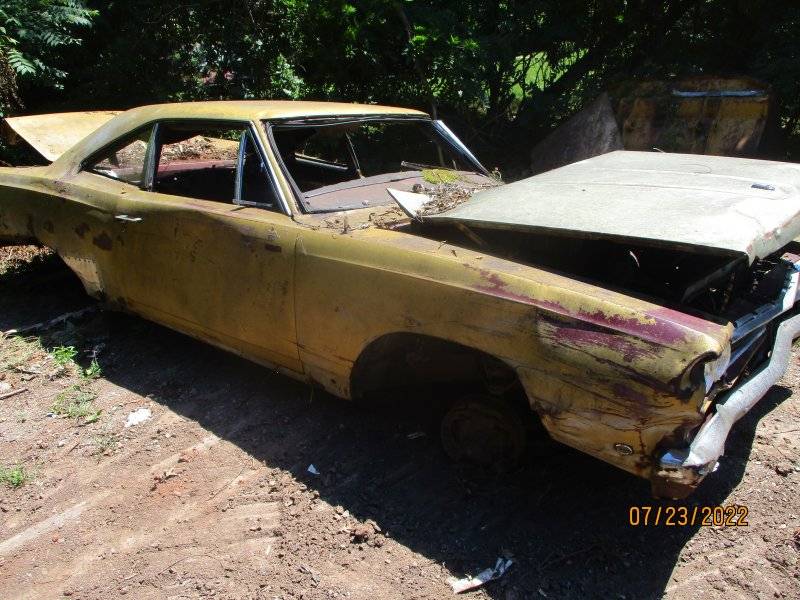

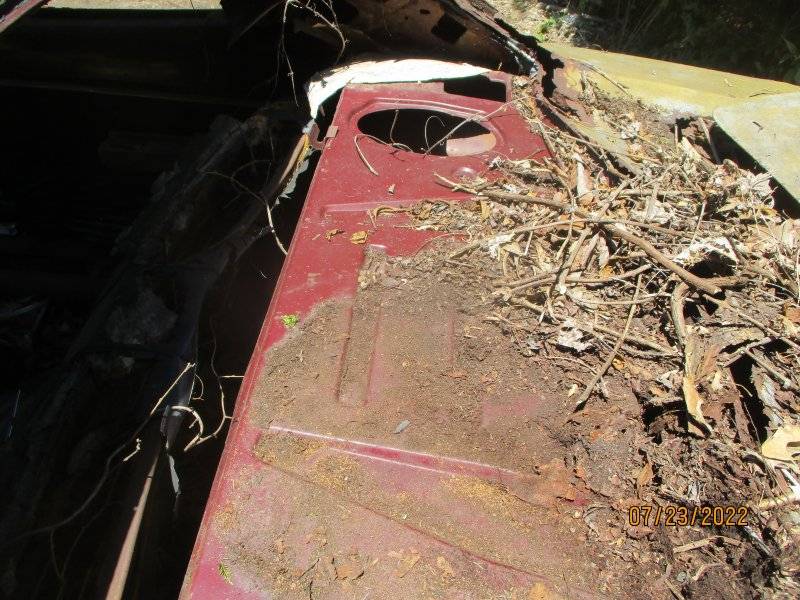

No title, No data build plate, no sales broadcast sheet. Just the vin on the dash. Car is rough and stripped of everything. It's a shell. Original color of car is that dark red (Moulin rouge?) The VIN says it is a 383 car. Pedals still in car. Any way to tell by the sales code numbers on the driver's trunk rail of when it was made. Reason is trying to figure out if it was an early made car in the year which would have the Inland shifter and later that year switched over to a Hurst shifter. Also, what would be the month date code I would need to look for in searching for a 383 motor and 4 speed to make it numbers matching? Also, the rear 8 3/4 and springs. Going to restore it back to stone stock.

Color is likely RR-1 Burgundy Poly or MM-1 Turbine Bronze Poly. Moulin Rouge wasn’t a thing in ‘68. Without a fender tag or build sheet, the rest of the dating stuff you’re asking about isn’t going to happen.

Moulin Rouge is Plum Crazy.

The VIN says it's a coupe. I believe the factory color to my car is Burgundy Poly.
Well, if nothing else you got $400 of clutch pedals and $200 of floor shift steering column out of the deal.
