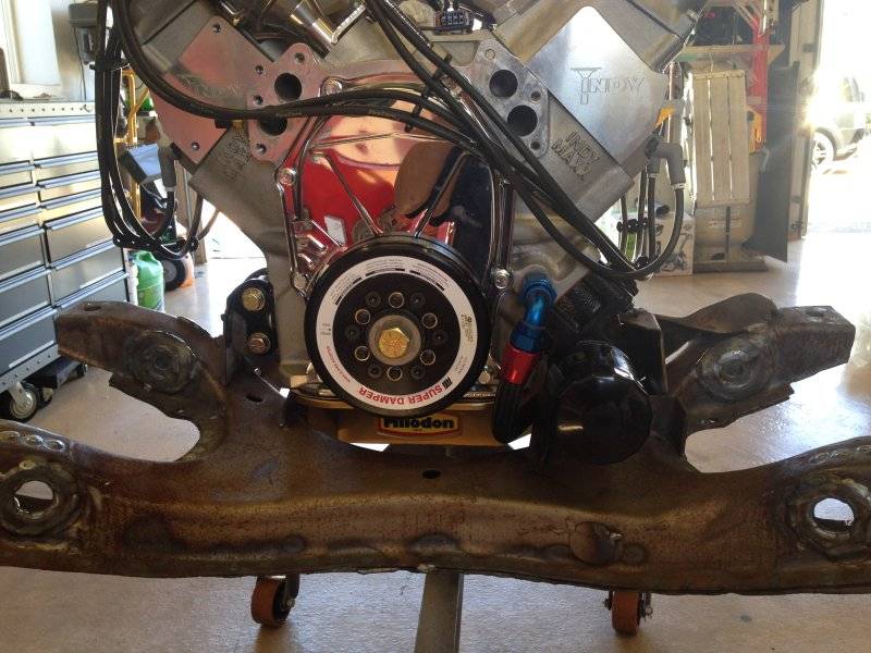

No clue as to what year it's supposed to be for, got it from a friend who worked at a Mopar shop some years ago. It is on a 70 k-frame though. Did that on purpose, my car is a 65, to move the engine back/have the better idler arm mounting/sway bar through the k. I also prefer the bar in as opposed to being in front of the k. Here is a shot of the front so you can see what I have for clearance to the filter. I thought I covered the k work on my thread, updating the super street mopar, in the members ride area but it looks like it was pretty minimal on pics. Do have way more, just must have brain farted back then. I can throw more pics on here if anybody want them for ideas.
