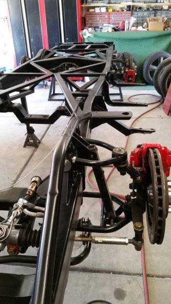

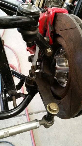

No, the modification is to the steering arm on the spindle. It is longer and has an extension that pushes the tie rod point down. This is a photo of the lower half of an alterkation kit. RMS then made me the upper arms and eccentric adjusters.
View attachment 1419505View attachment 1419506
This is really good information and specific details that help make the decision about cost versus benefit. Thank you for your posting pictures.

Is that the only modification? If RMS is forging new spindles, maybe they changed the Ackerman angle as well. I don't know how Ackerman angle is set, but I'm guessing the axle stub or steering arm are titled one way or the other. A couple degrees change would be hard to detect without measuring for it.

If Iron isn't hardenable, can it be "forged?" AFAIK (which isn't much), forging is for steel or aluminum. I doubt the Pinto got expensive forged components, or that the Mustang II did either. So if the RMS spindles are forged, and are steel (or aluminum, I doubt aluminum), than they are an in-house spindle; or an aftermarket spindle they got from somebody else. The latter makes more sense if RMS is cutting off the steering arm and welding it back in a different position.
Speedway Motors has the Mustang II spindles in "heat treated alloy steel." I found a thread on a vintage Mustang forum talking about the possibility of Global West making forged aluminum spindles. Global West makes aluminum spindles for GM's a-body. I don't know if they ever made them for Mustang 1, 2, or whatever - but if the Popular Hot Rodding guy correctly identified the RMS spindle as "forged," than it looks like it would have to be aluminum. That would reduce unsprung weight and give an advantage over the factory cast iron spindles, but the idea of an aluminum steering arm welded onto an aluminum spindle is a little eye opening. I'd hope the guy doing the aluminum welding is a champ who never has a bad day.
No, I know for a fact that the RMS spindles are iron not aluminum. I have installed several RMS alterkations.
It wouldn't be hard to tell if you've held one. So either it's possible to forge iron, or Popular Hot Rodding messed up and they're cast. Have you seen anything from RMS that says they are forged?
