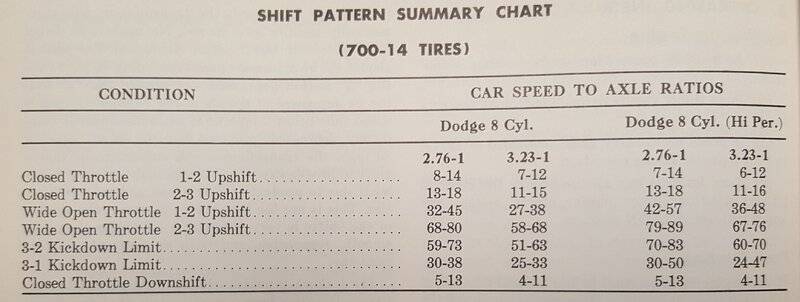

Yeah, you’ve got it. Doesn’t move as far, ends in the same place. Starts more compressed. Start point is pretty much where you can feel the spring engage in the tranny. Total throw is 1-1/8. Average acceleration 1-2 shift at 20, 2-3 at 30+.

What I do is disconnect the kickdown rod at the carburetor, hold the carburetor wide open and push the kickdown rod back as far as it would go, then compare the location of the two. Make the adjustment so the rod will line up with the carburetor linkage hole. Take it for a test drive and note where you shift points are when driving normally. If it shifts too soon from 1st to 2nd you'll need to lengthen the rod, too late shorten the rod. It only takes about a 1/8" of adjustment to make a big difference once you get in the "zone". That's where the rod has enough pressure on it to start making the shift points work. (727-8 transmission)
