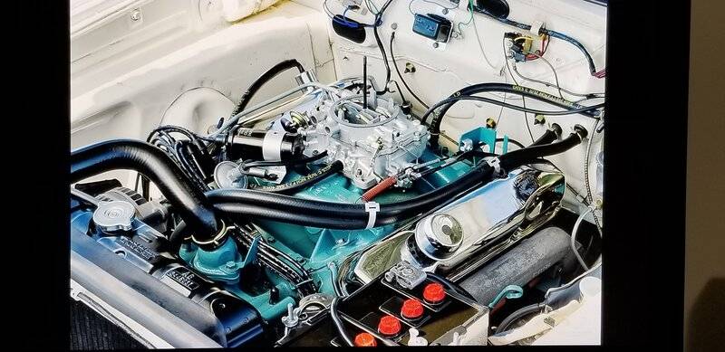

Red this is my original 361 from the 1962 Polara with factory 4bbl. You can see the added piece that they placed on the "U" shape in the bracket. Looks like it might have been an after thought or even a recall quick fix. I've seen several others just like it. Also you can see that the bracket is level or square with the engine, not at an angle.
Hope this helps.
Mine is sitting at an angle because its on an aluminum intake that isn't flat like the factory one. I think its coming out because its not adjusted correctly. Nate had sent me one that he had fabricated but when I sat his and my factory one side by side they were almost identical in shape so I just used mine.
