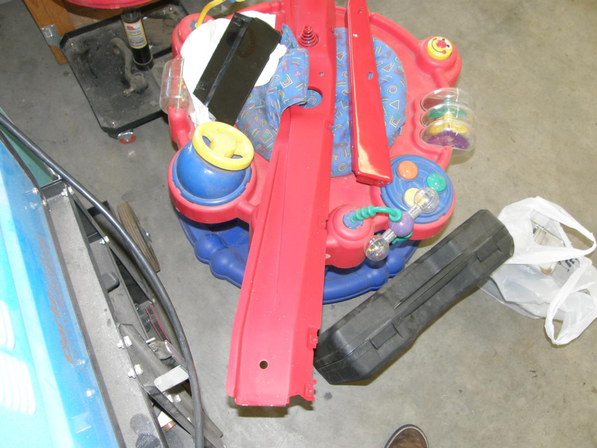

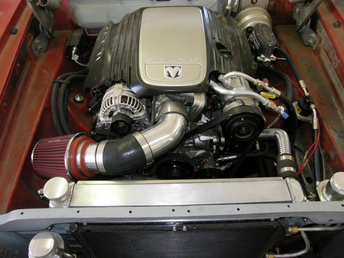

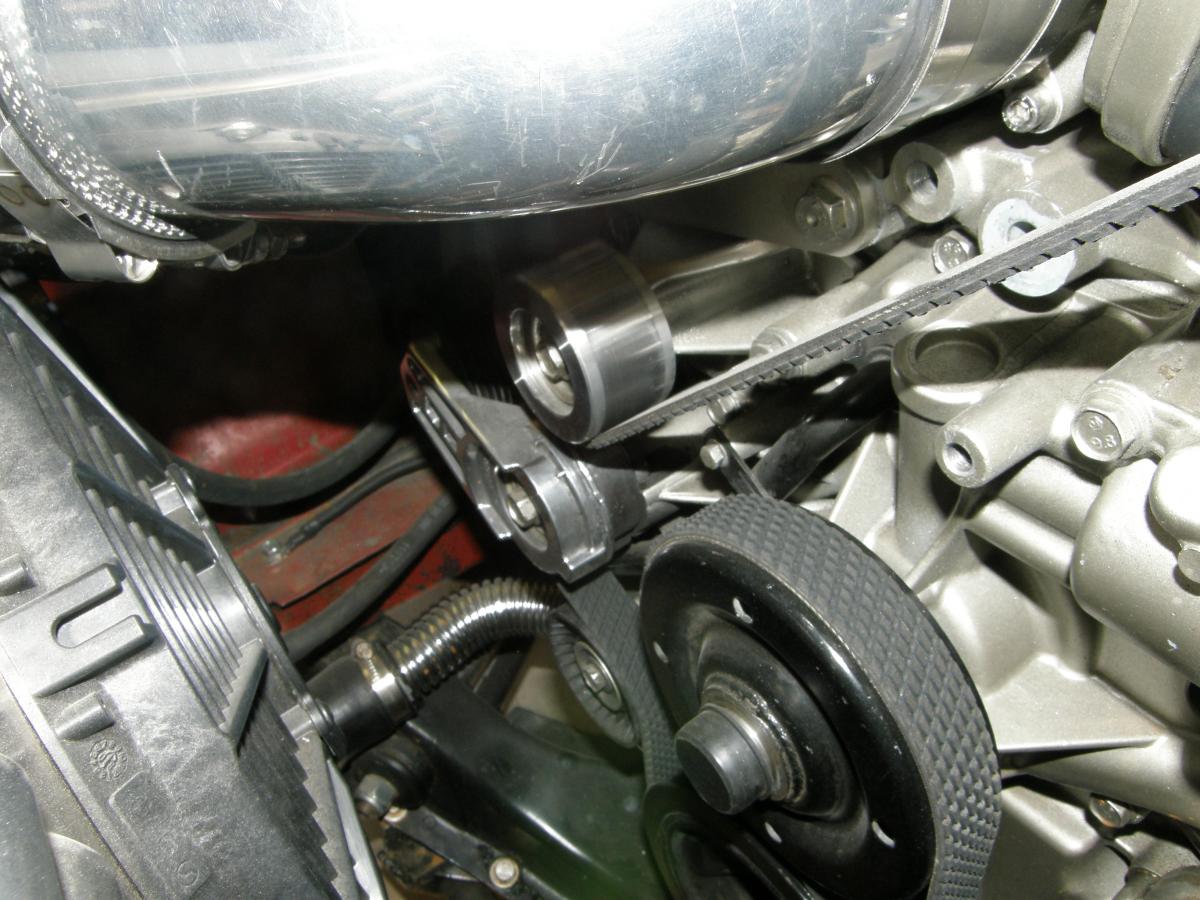

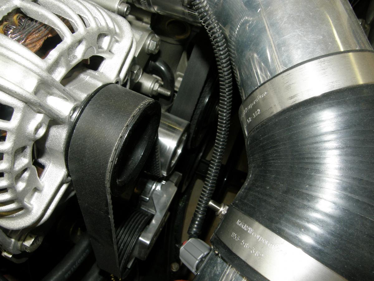

Finally the pics as promised----better late than never!lol.
I haven't figured out how to post video, and I'm lazy er, uh, busy with the kids. On a serious note, I don't know how to post video and my better half works soooooo much during the summer, that most of "car time" is late at night after they've gone to sleep. So firing up the car would not sit to well and I like having a better half----happy wife, happy life! Thanks for the compliment, one other note, some of the work I do is done at work on lunch break, if it won't take to long, such as the billet pulley.

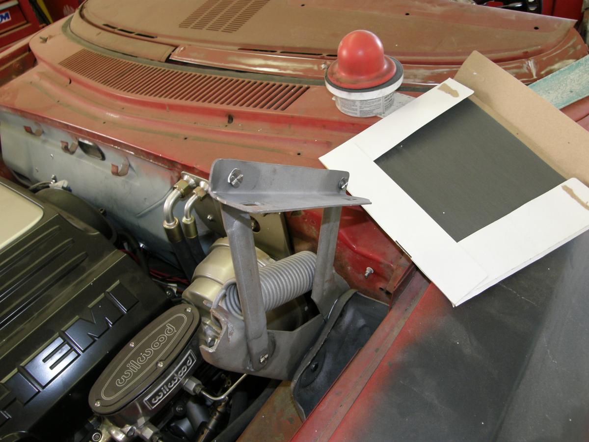

Looking good 5.7, be careful with the overspray from that primer around the kids toys and stuff, you don't want them putting it in their mouthes. I just finished going back through your build, what did you use for a converter (inspection) cover on the trans. There must have been one on there when you got it?
I still have the stock piece, but probably wont use it. I dont see the need for it.

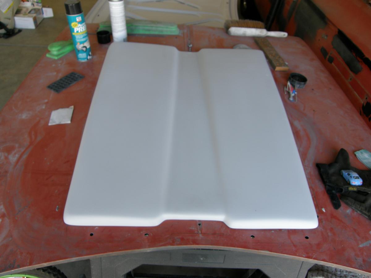

Trunk lid primered, now moving onto the hood.

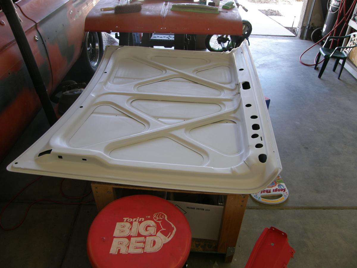

Give it 2-3 coats of primer, guide coat it, block it out with 150-180 on the longest board you have, then 2 more coats of primer.
This polyester primer is some thick stuff, so I'll do what you suggest.

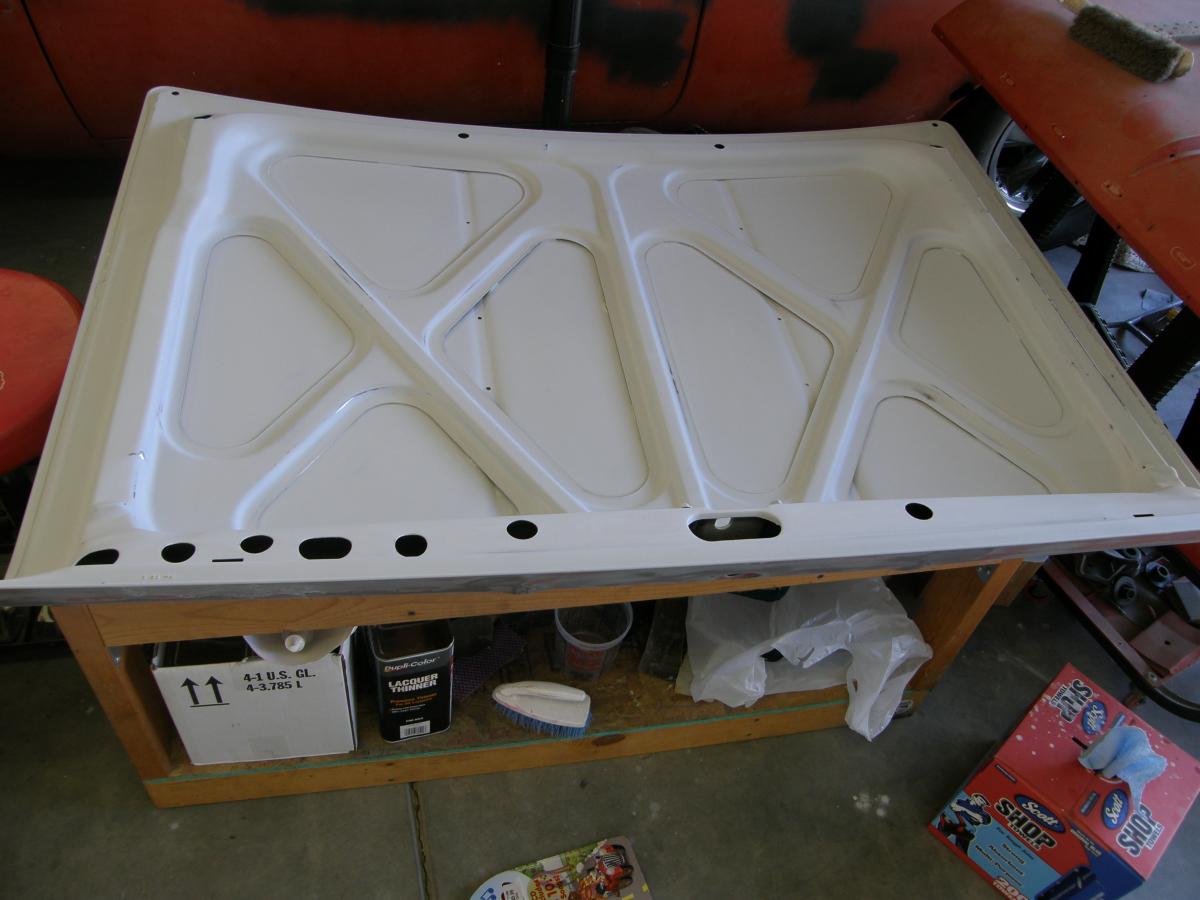

Trim holes welded up on the hood, a minute amount of filler and they dissapeared. Now sanding my arms off on the underside of the hood---maybe I should just blast it off and be done in 10 minutes or less.

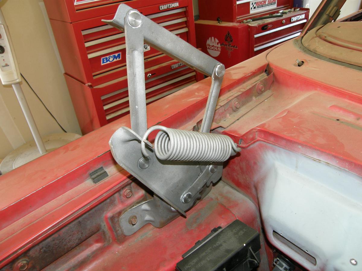

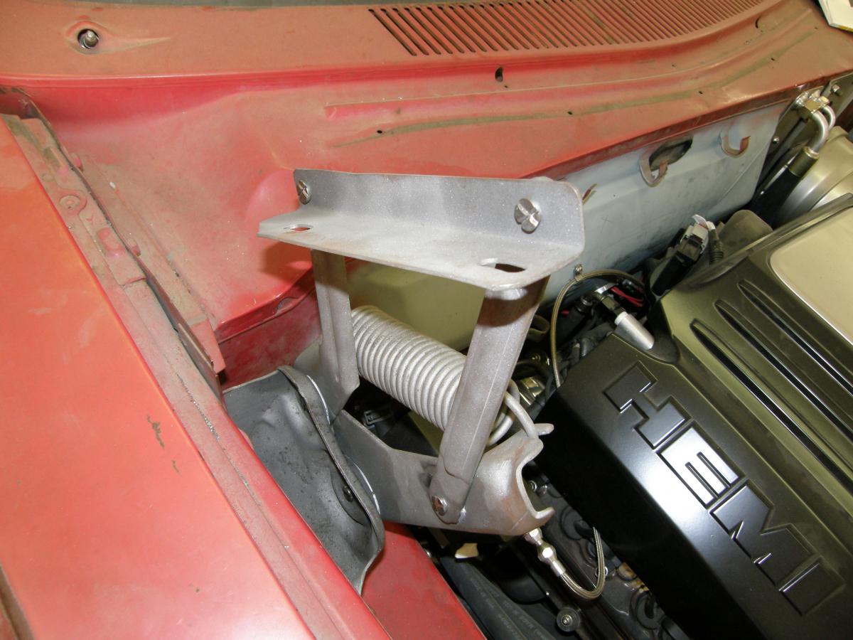

Well the blaster crapped out on me, so I had to do it by hand, took about 45 minutes. The under side of the hood then was primered, dried all night, then primered the top. My dad stopped by to help me put on the hood and decklid. I must say the rebuilt hood hinges worked flawlessly. I mounted the scoop, man it does look bitchn' if I do say so myself, so I some clean up to do for the show this coming Sat. I imagine that there will be tons of questions and I'll do my best to answer them.
