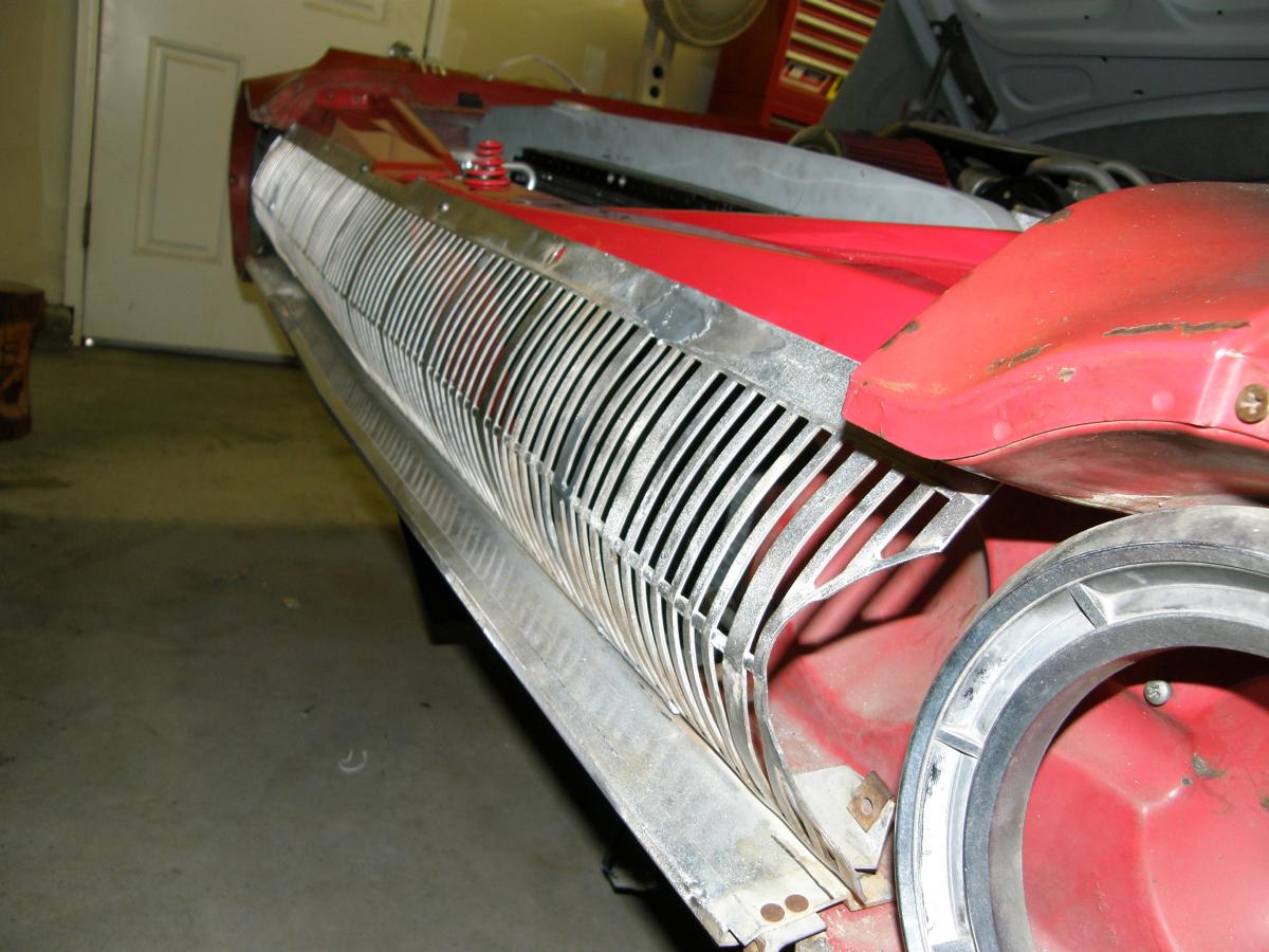

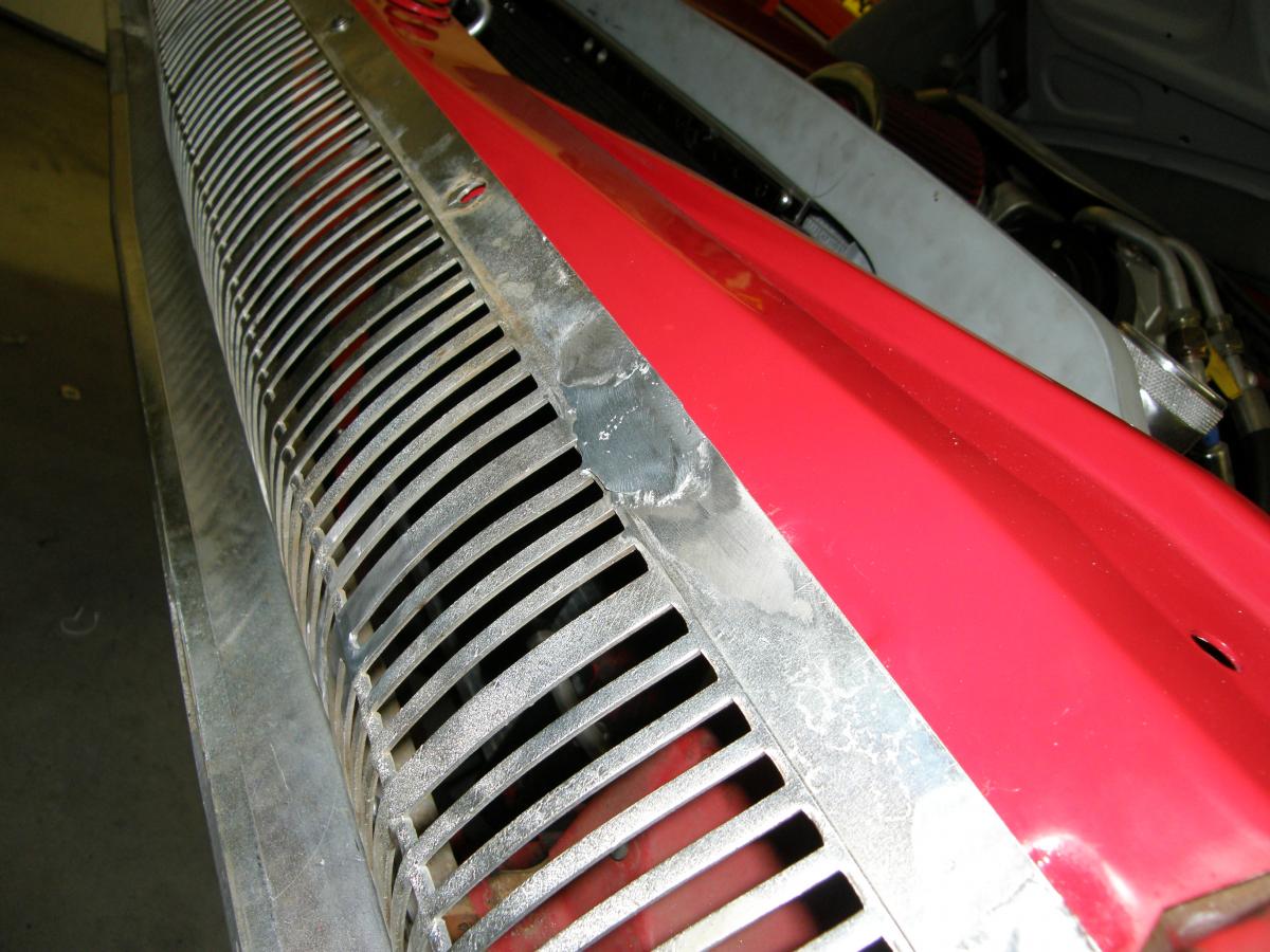

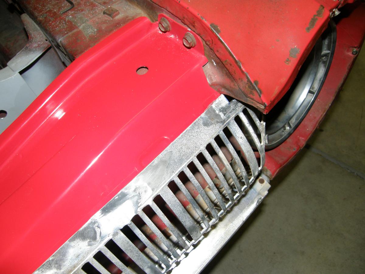

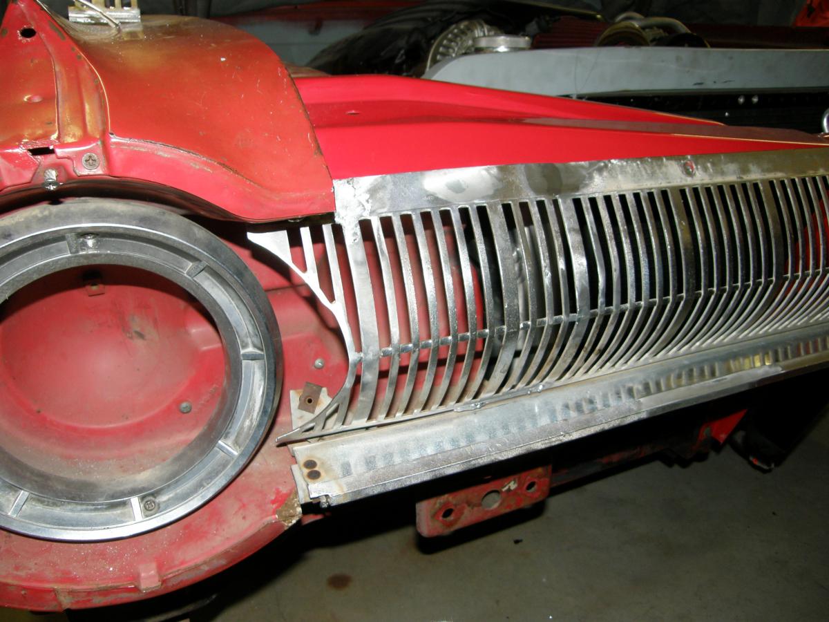

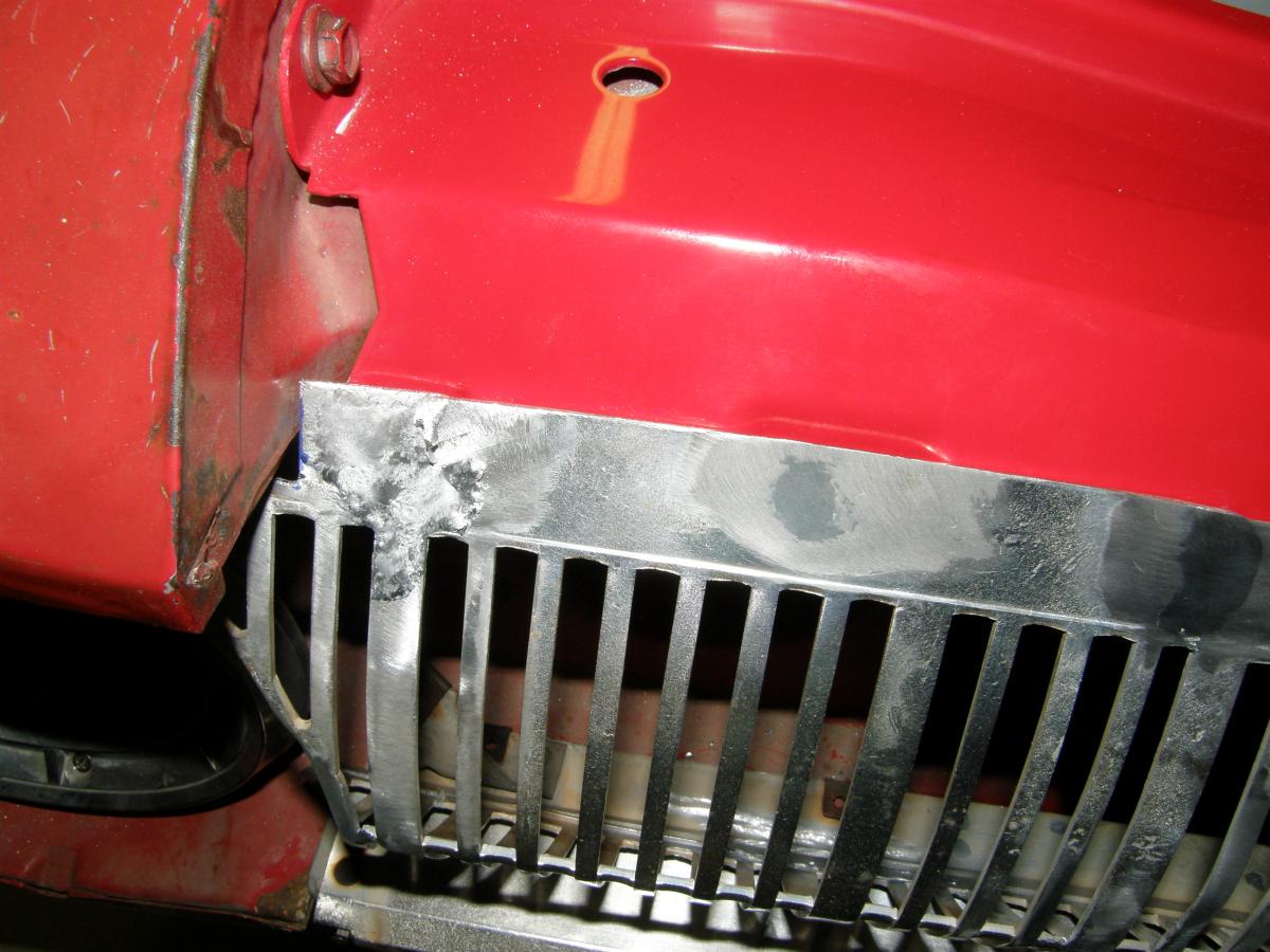

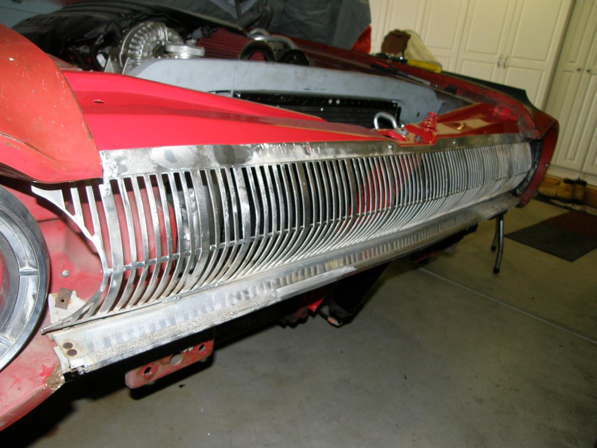

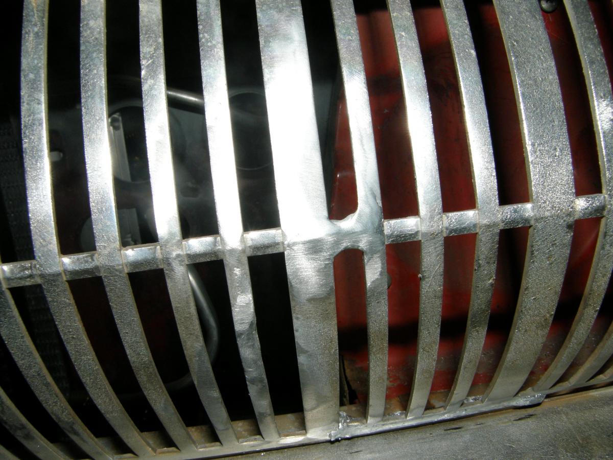

Damn near done---wel I was done but the tacks I put on the drivers side cracked so I'm doing the final stuff at my dads, so hopefully pics will post on Sat. night----so close I can taste it!!!! Or is it the fumes getting to me??????

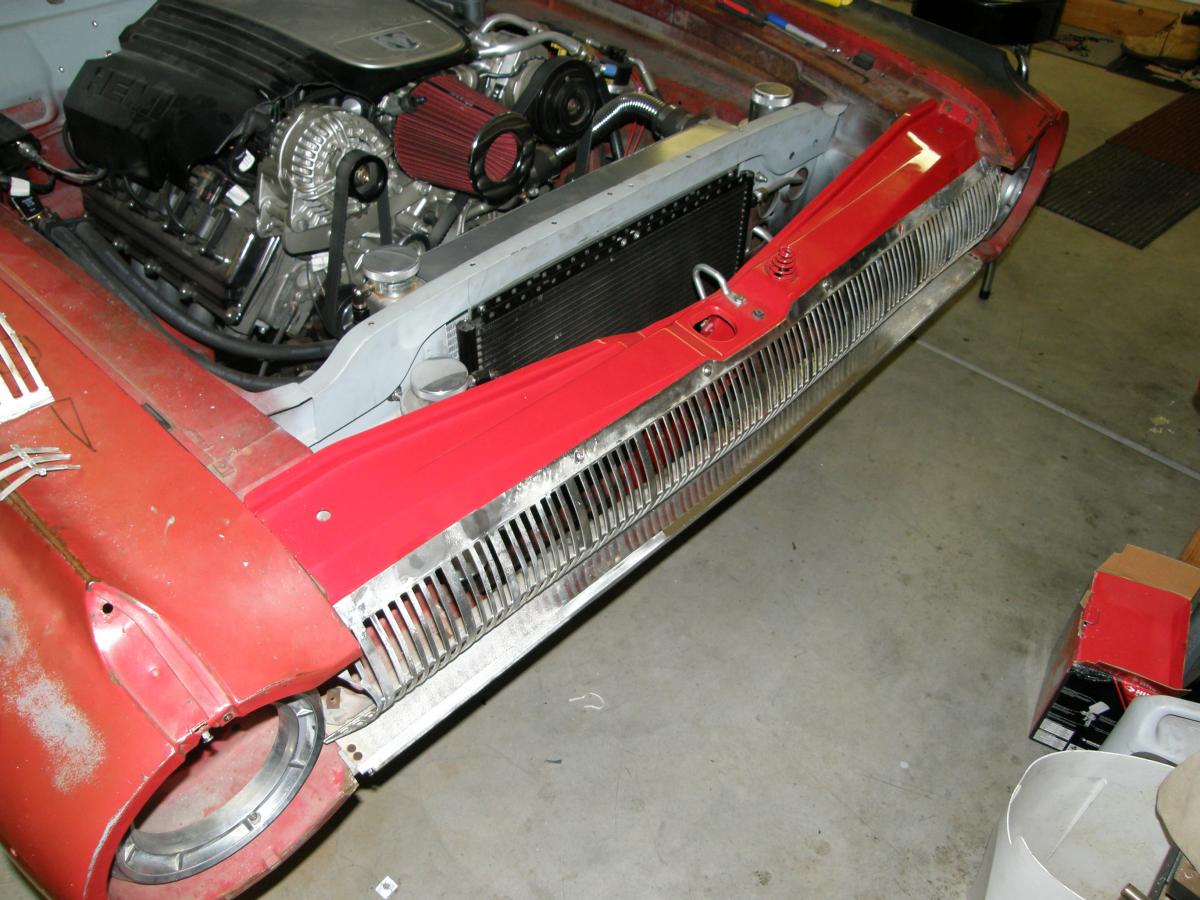

All welded up and on again for mock-up. Still have to do some sanding and filing, but getting there---slowly.

That makes two of us. If it turns out half way decent, I'll be happy.
Started to strip off the anodizing today.Comes off pretty easy with a 3 inch Scotchbrite pad on my angle grinder. Hope to finsh stripping by the end of the work week---but no promises.

Grill is looking good.....
Thanks, still working on getting the anodizing off. I think I'll send it out to get it bright dipped---way too much hand polishing for such a delicate piece.

Almost finished getting the old bright dipp off the grill. Then it will be time to decide if I get it chromed, bright dipped, or anodized---what do you think should be done? Keep in mind this is NOT a resto or even a remotely correct build, so with that in mind, let's have some opinions
Grille is completely stripped, and I worked up to 600 grit wet sanding today. I'll stop wet sanding when I reach 2000 grit, then I'll polish a small area and see how it looks. I'll post pics of what I got so far asap.
